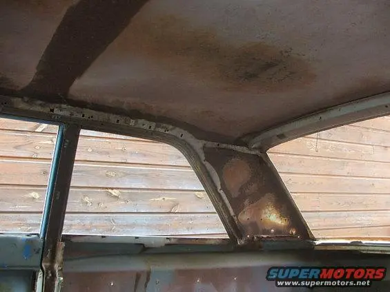

He needs the inner structure behind the B-pillar/rear sail panel.
I have a picture of the area off my '63 Fairlane. I cut the structure out to lose weight as it'll be a drag only car with a full cage. You can still see two overspray spots where the structure allowed the paint thru to the inside of the outer skin.
That would be the inner roof frame . It is not reproduced . You either have to scab in pieces to fix whatever is wrong or get a bigger donor piece from a parts car . I had to fix mine , it's not hard but it's not fun either .

Yup, that and the roof skin are not reproduced. I don't think the package tray support, nor the inner structure for the quarters in the passenger compartment, nor the panel that the seat mounts to below the package tray are reproduced either, or last I knew they weren't. You'll have to cut them out of another car. I used to have a parts car that was an early '65, but it's gone now.
