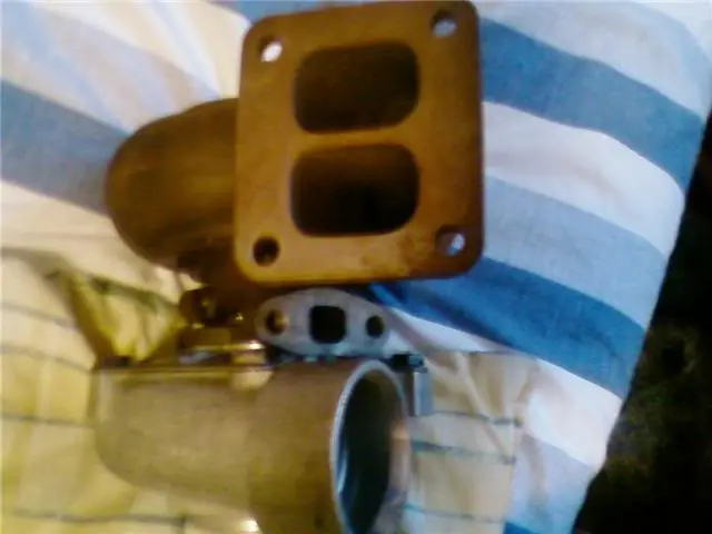

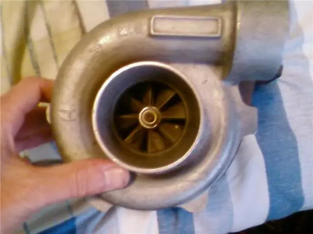

Is $700 a good price for turbos?
Part #is 409760-5002 S/N 0H0117
I couldn't find any info on them.:nonono:
They are airesearch Turbochargers and by Garrett turbos
They look to be rebuilt.
Go or no go?
It doesn't look good. :notnice:
You really need more information to make a decision.
It appears they are T04B26: Part Number 409760 - Search Catalogs in TurboMaster
Perhaps from a ~160HP John Deere?
Ask for the A/R's; if the A/R is indeed 1.52, you'll have to wait a long time for it to spool.
Next, get the wheel part numbers from that turbomaster link, then go to the wheels section, and retrieve the wheel dimensions so that we can calculate the trims. Or, ask him for wheel dimensions.
You'll need wastegates ($$$) if you plan to use these.
Oh, BTW, I paid ~$200 for three functional T3s, all though I will admit that they weren't freshly rebuilt.
It's only a bargain if you can use it. HTH. :flag:
