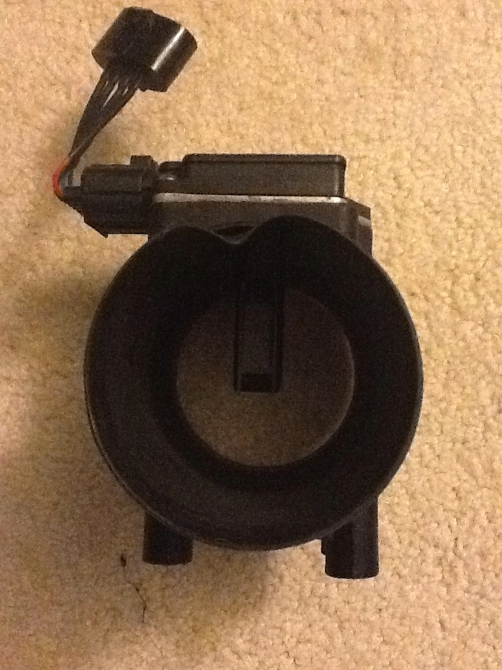

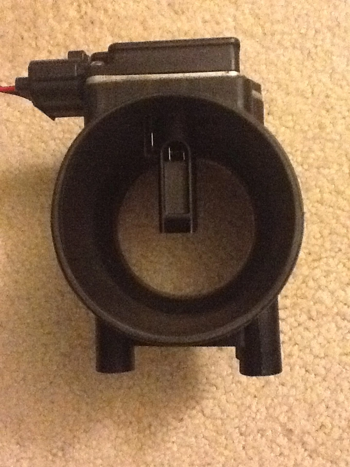

well, it was new. so it didnt need to be cleaned, and the connector is free of corrosion. i havent checked for continuity in the connector, but i did search and find some info, just not exactly my situation. More importantly, i just removed it and noticed i bent the plastic in by overtightening the hose clamp around the inlet side of the MAF. Unfortunately, it bent in directly in front of the sensor wires, so i cut the bad piece off and smoothed it all out, as well as cleaned up the wires. I will install and test it out tomorrow. They used to be metal, idk why this one is plastic.
ive never seen my check engine light go on. Even when i dumped the codes. Mine was made by massairsystems which i was told was the Pro-M sensor after they were bought out by another company a few years ago. I plugged it in today after removing the bent part and cleaning the wires, and it still makes the car run like crap when its plugged in. :dammit:
