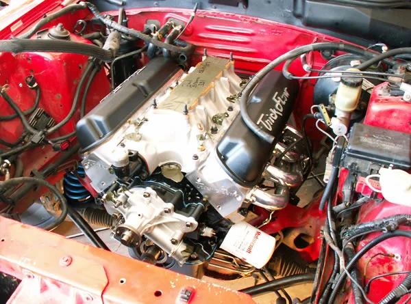

gcomfx.com Founding Member Oct 22, 2002 3,690 0 56 Republic, MO Nov 20, 2007 #5 Nov 20, 2007 #5 Not the best pic... but I swiveled mine over onto the fender and put a floor mat under it. Attachments new_engine2.webp 72.8 KB · Views: 192
