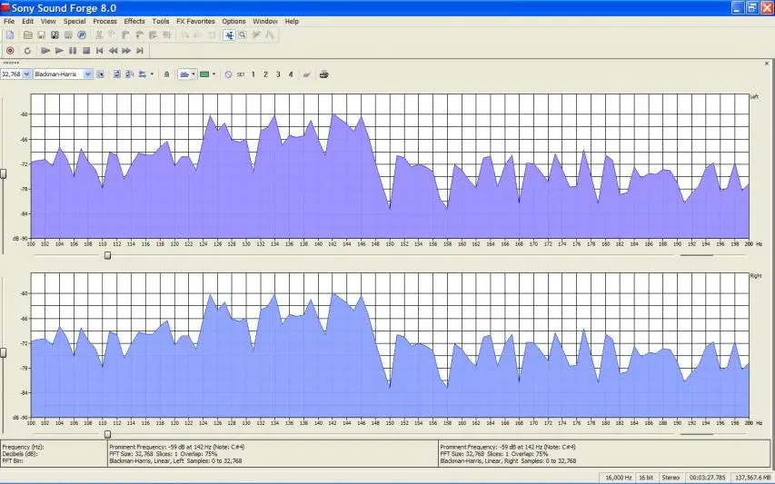

My only complaint with Magnaflow is that the drone under load at 2k is annoying and the pipes, especially at the hangers, themselves seem to be getting more rust than I would have expected.
Here are two files, one of an analysis of my Magnaflow systems sound after recording a short trip under load. I tried to keep the car at 2k RPM to aggravate the drone.

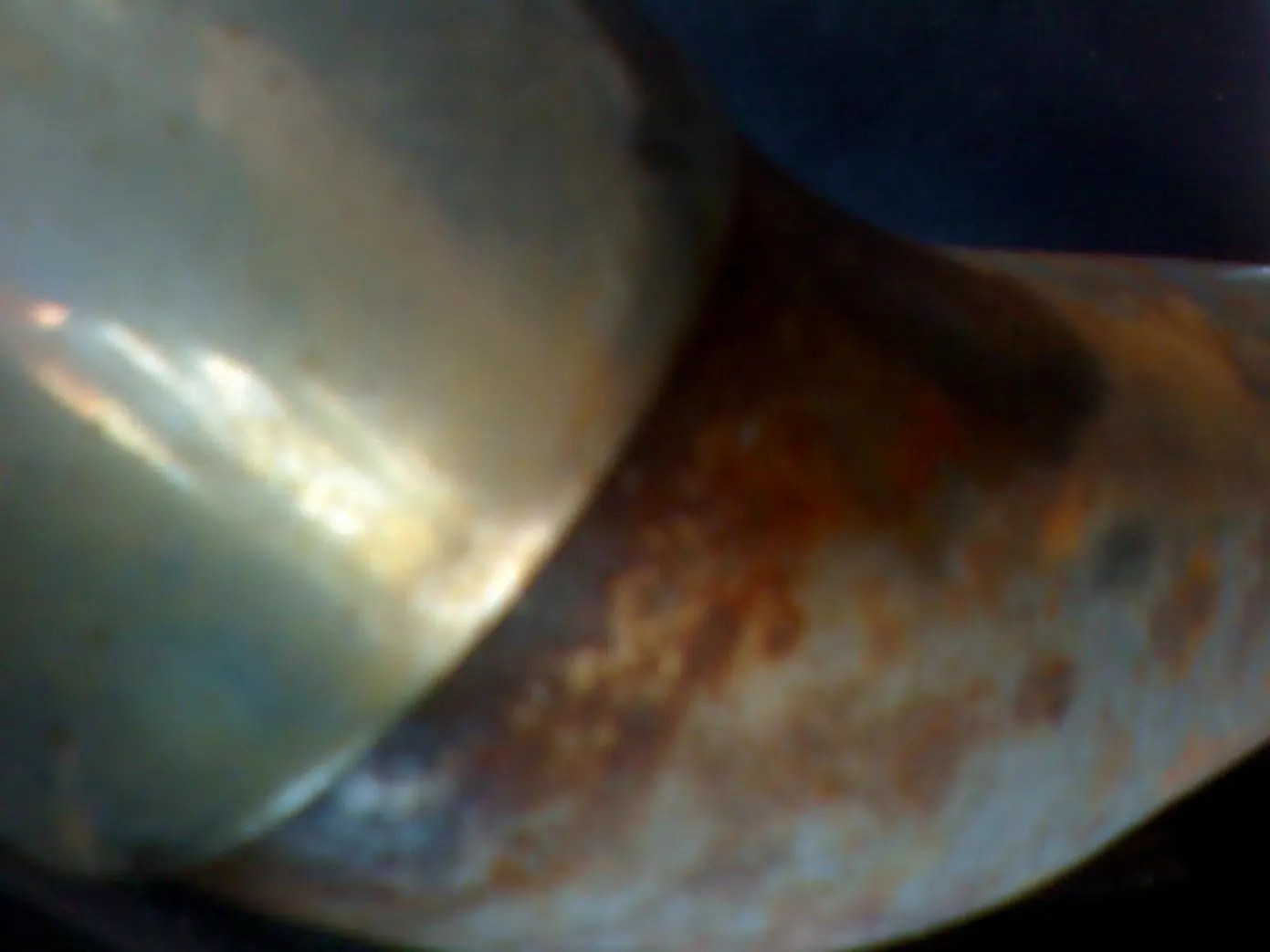

The other is a pic of my 1 year old Magnaflow system rusting.
The 5 year old (2003 GT) stock system which is laying outside in my yard for a year, through a Northeast winter, actually looks better.

They sound great but I disagree with you on the rust.
See my last post.
That pic is after one year on the car.
The mufflers themselves are still perfect and nice and shiny, but the pipes and hangers, well you can see for yourself.
Look at the picture I posted.
That is after one year, almost to the day.....
Let me try to clear up some things in regards to rusting. What you are experiencing is surface rust which is not detrimental to the system’s integrity. Surface rust usually occurs in excessive humid or wet conditions and particularly in areas where the roads are salted. This can be easily cleaned off with a scouring pad or a Scotch Brite sponge with soap and water. Stainless will not rust through however stainless is still susceptible to surface rust due to its physical properties. The system does carry a lifetime warranty against being rusted through.
