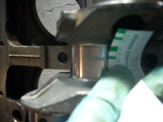

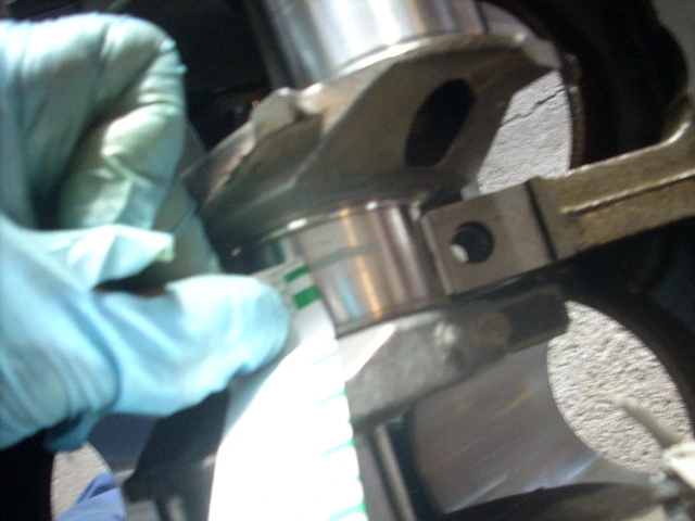

I have a stock 302 block with a stock crank and standard size bearings. I checked the bearing clearance with the green plastic gauge and it is .002 is that within specs?

i go by the rule .001 per inch of journal diameter. if it were a cleveland or windsor main i would want more like .003 for the cleveland and about .0005 more for a windsor. but on a 2.25 302 main, id let .002 eat if its just gonna be a street motor. id like to see .0025, but i dont think you are going to get into ten thousandths increments with plastigauge.

Actually that crack is in the crank and it looks like it's on the verge of a catastrophic failure.
Regardless of where the crack is,...OP doesn't seem too concerned that he has an engine w/ such a devastating canyon running through it that will potentially break into two, ballistic chunks of 200+degree farenheit metal, flying apart at 7000 RPM...
I think, hope anyways, that all the posts made in reference to the crack were just a joke. It did require a double take when i first saw it.
Agreed....Id let .002" eat all day in stock style motor with no problems at all. You should find a similar clearance on the rod journals....
