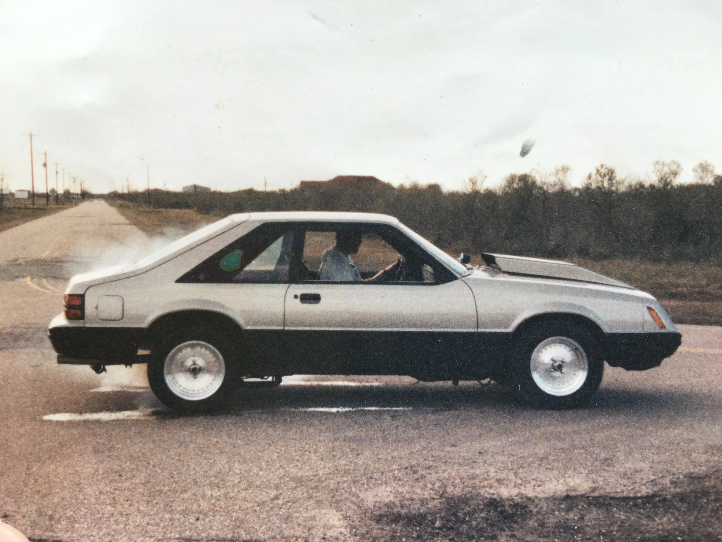

Back in teh day... 90 or 91 i think. One of the only photos I have of that car. Dude I sold it to put an aero nose on it and painted it blue. Looked like every other fox on the road after that.
