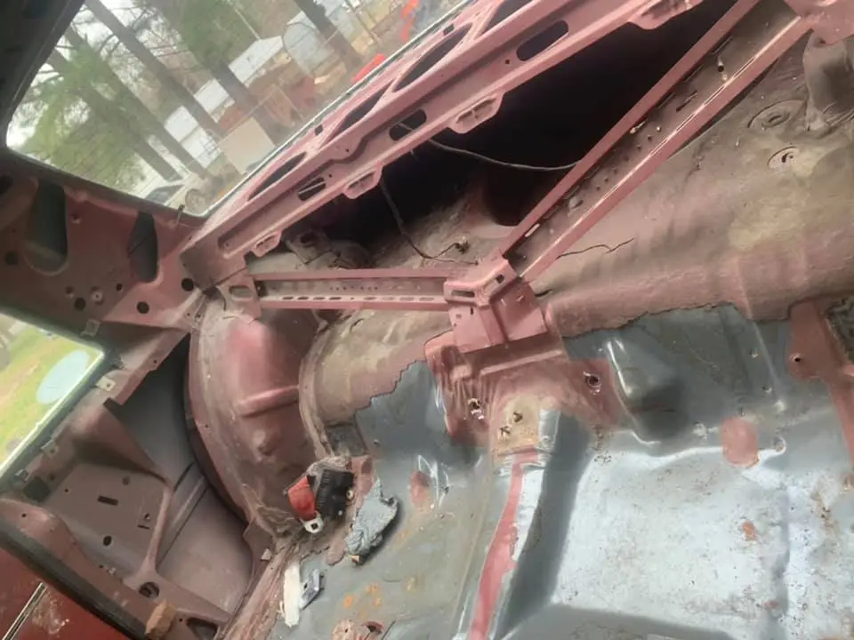

I don't have a foxbody...I have a 66 coupe...but I want to adapt the foxbody coupe rear seat divider braces pictured here to the 66. Is there anywhere to buy these aftermarket? Or am I going to have a grand old time hunting down a coupe to chop up? For that matter...I could care less what car this type of brace actually comes from I guess, I just figured there is a possibility of an easy aftermarket source with a foxbody.

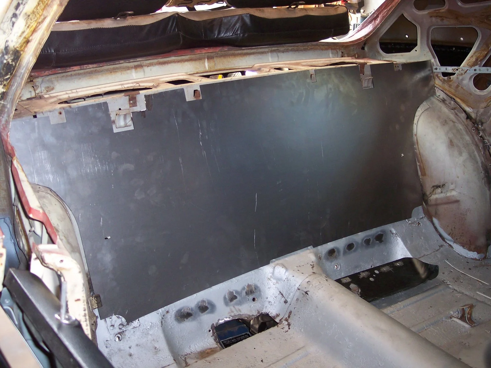

Because the early mustangs don't come with this bracing....and while you can buy panels like this:
People who do so have reported a SIGNIFICANT increase in torsional rigidity....however, I think with bracing the results would be better...maybe it would give better rigidity than a floppy piece of 18 gauge steel, maybe not, but it would certainly take away the snare drum effect of a large piece of flat metal covering a large opening. I already have a panel like this....but I think it will be more effective in conjunction with foxbody-style bracing...after all, Ford obviously felt it had an effect worth the extra expense in 1979.

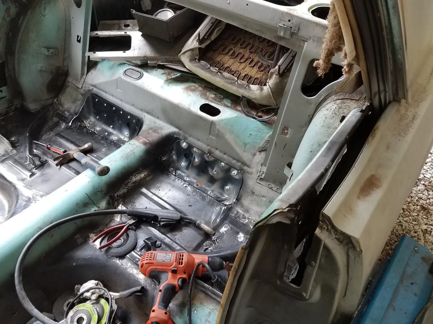

Can't be that...the package tray has no significant amount of weight:
this is my 66...vintage mustangs never had any problem with package tray sag without any bracing...and even if that was the purpose the V bracing in the foxbody pic above would attach at the TOP in the center, not the bottom.
