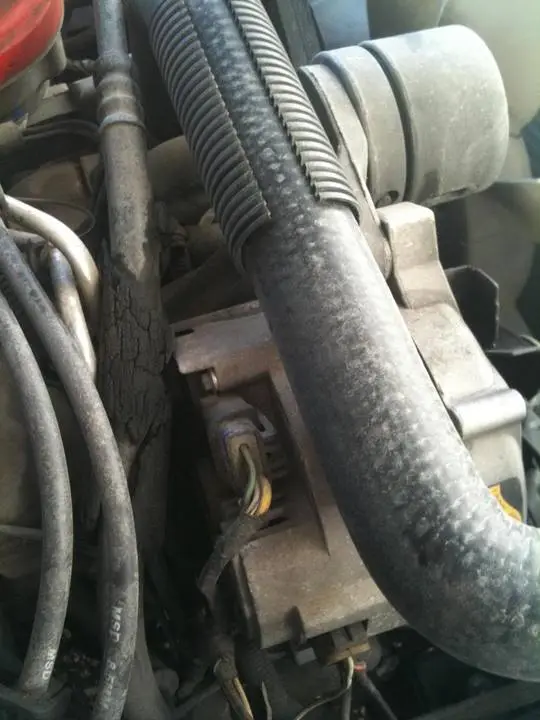

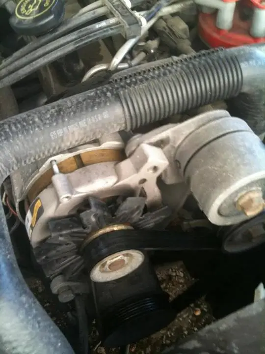

I had a local guy look over my "new" 92 and said this was the upgraded alt.... is it?
please oh please...

I know this has been beat to death, but IMO do NOT cut any wires. There is no need to. Simply splice into the stator wire on the old 2G wiring with either a female adapter or get the adapter from the boneyard. The D shaped plug from the 2G transfers over to the 3G. Run at least a 4G power wire from the post on the 3G to the battery side of the starter solenoid with an inline 150 amp fuse. Make sure you add another 4G ground wire from the block to the chassis.
Just tape off those wires and tuck them back. IMO do NOT hook up the2 black/orange wires to the post on the 3G. Those wires are notorious for burning up with only the load from the 2G. I've done dozens of Mustangs this way with no problems.

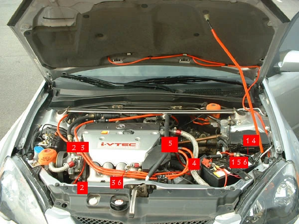

I think did misread your posts. What i was referring to was the current trend in the import world to basically ground the hell out of anything and everything...like so.
What you are referring to is proper grounding technique. But tossing on 3 engine to body grounds just because there was an empty lug is a different story.
LMAO!!! That is some funny shiiiiit... Between the fart tubes, 10 foot wings, neon lights, 8000 stickers that add 100hp, fire extinguishers, 1000 watt stereos, lambo doors, and NOS bottles that arent hooked up (nitrous oxide to us old timers), they take stupid to a new level.
