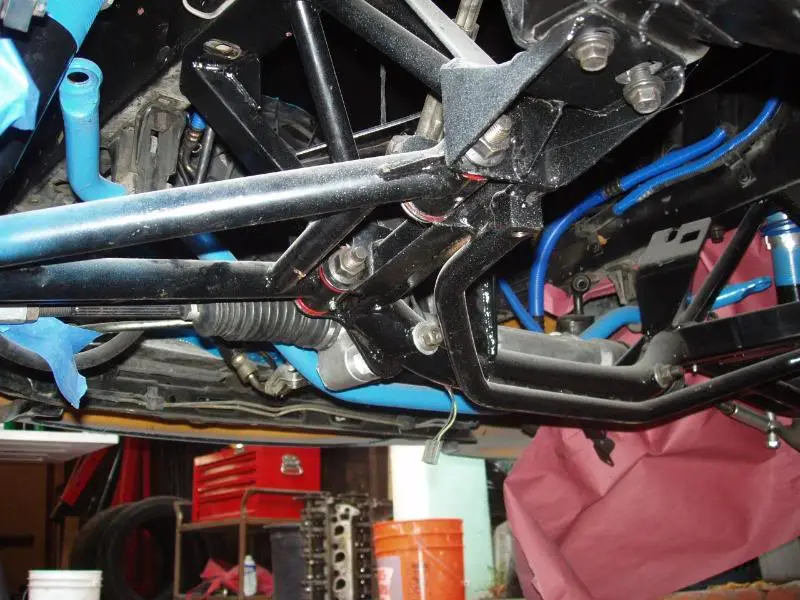

Can anyone tell me if this is a MM or MMR K member. I have a line on it for a great deal but I only want it if it is a MM set up (which the seller says)
I really dont want to drive the 2+ hours each way to find out it is not what I want.

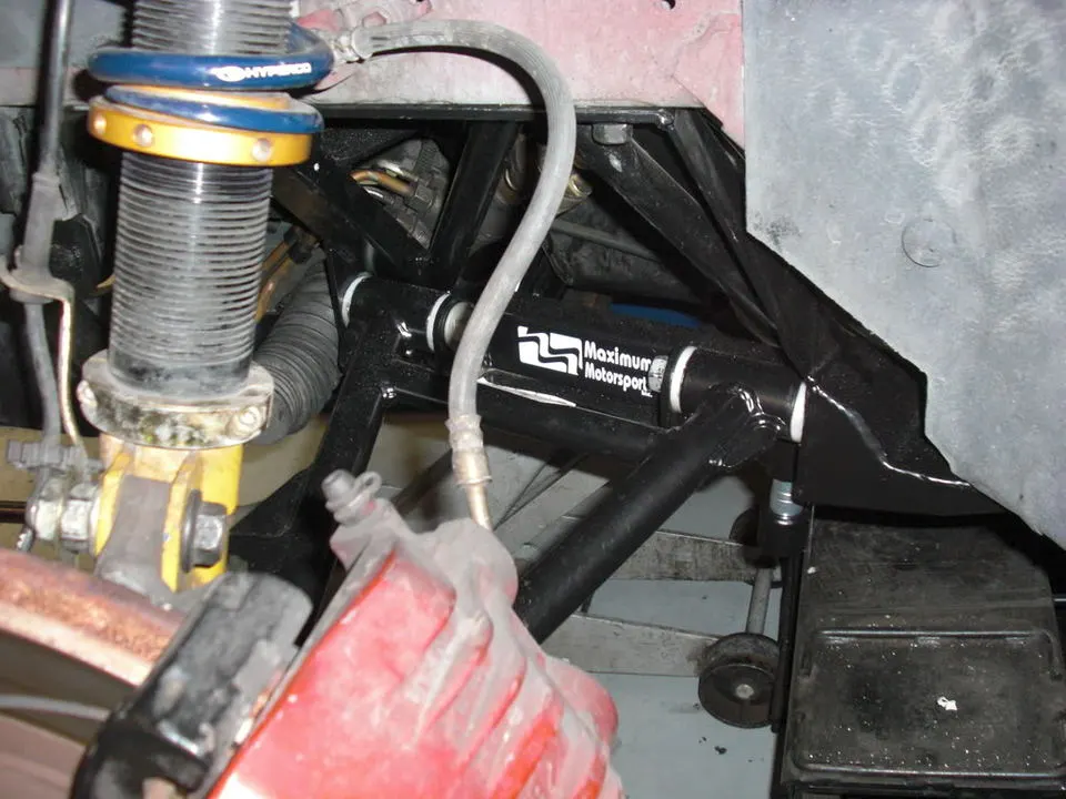

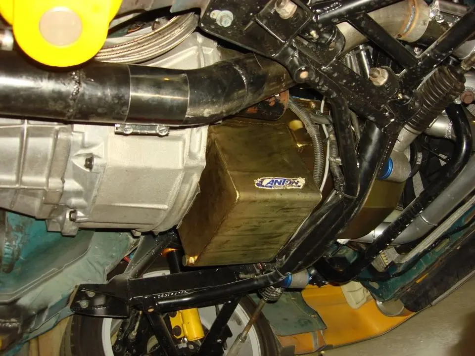

I am pretty sure that the MMR is a copy of the maximum motorsports one so good luck getting a definitave answer from a picture like that. It looks like the mm one but
Looks pretty close to my MM k member, BUT, its missing the MM sticker by the A arm mounting holes, & also looks like its missing the k member brace? Whats up with all the blue overspray?
The price makes me look right past the over spray, my MM K on my fox has no stickers near the a arm mounts. Damnit I just need to know for sure, I will call MM tomorrow and ask them.
Here are some more pictures, don't mind the paint..... I really need to know if this is a MM K or not, as I am supposed to pick it up tomorrow and MM Tech is closed today.
hope you didn't buy it. looks like a granatelli/mmr k-member from the pictures.
the inner a-arm brackets are thinner than the outer ones.
the threaded holes for the g-load brace are square. notice the pic posted of the fox one is round. the ones for my 96+ mm k are also round.
steering rack bushings are raw aluminum color and super thick. all the mm pics posted (and mine also) are the thin blue 3-piece design.
