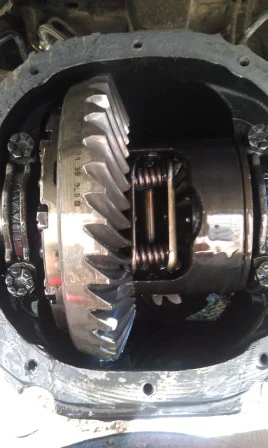

Is This A Standard 8.8 Limited Slip?
redwings06
Mar 23, 2006
33
Does anyone know if this is a standard limited slip set-up or something aftermarket? Thanks!

It's a "limited slip" diff.
You can tell from the springs. Probably a clutch type, similar to the "Traction-Lok" Ford part.
I'm pretty sure conical units or locker units (rachet type) don't use springs in that position.
I have a Torsen in my truck, and it doesn't have any such springs.
Open units also have no springs.
