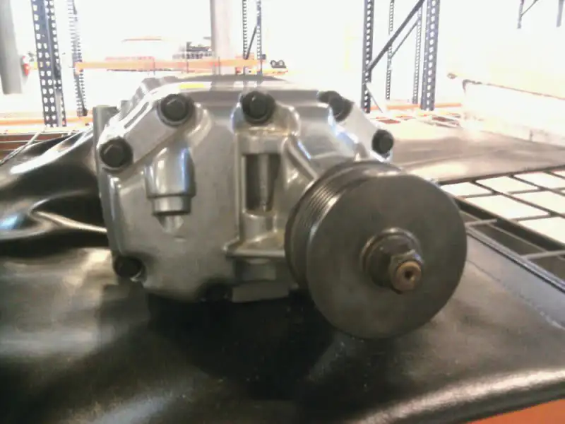

if so, ill be needing the cobra plenum as well but ill need the inlet that the plenum bolts to correct?
is this the cobra blower?

Honestly it looks like the TBird blower.

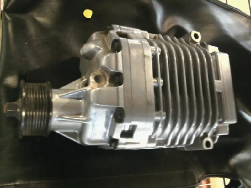

yep...i just spent a few hours researching...anyway, is there anyway to swap to a saleen snout? the bodies of the supercharger are completely identical, just this one has a shorter snout...i got the blower for free so this is why im asking....
if the snout swap is possible, shouldnt i be able to put in on a saleen intake manifold? im willing to give it a shot at this point....and yes i know, i can buy a kb or vortech blahbity blah, but im just trying to hit about 370hpish

ok so i have confirmed i can use the saleen lower manifold to bolt this to... the only thing i need to know for sure now is if the snouts are interchangeable...if so, does anyone know where to but just the snout?

It's a 3rd Gen M90 found on a '94-'95 Thunderbird SC. Its probably the most desireable of the factory M90's and the same one used with my Allen kit. Assuming the Saleen Blower is a Gen 2 or 3 (Series I or II kit), the snout will be interchangable. You can buy any number of different snouts directly through Eaton.
If you're looking to make some power and have someone that can fabricate an inlet, you should dump the M90 idea and transwer your internals to the Magnum Powers MPX case.
They're much, much more efficent by compasion, can be spun just about as fast as you're willing to try and will make considerable more power.

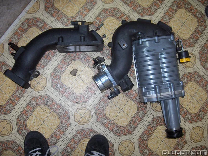

probably a dumb question but how come the snout on this one is bigger than the one i have?
http://cgi.ebay.com/ebaymotors/Ford-Supercoupe-EATON-M90-Supercharger-Brand-New-_W0QQcmdZViewItemQQhashZitem19bed463abQQitemZ110575772587QQptZMotorsQ5fCarQ5fTruckQ5fPartsQ5fAccessories
would that snout work? im having zero luck at finding the saleen one.....starting to lose hope here lol

The internals themselves will be the same between the blowers. A 3rd Gen, is a 3rd Gen. The nose drives however will be different. Upon looking at your comparison pictures, it's possible that this blower was on something else other than a Supercoupe, but it's still a 3rd Gen case.
You can check through the various nose drive selections as well as specs an confirmation on the blower you have here. It should give you a good idea as to what you'll need to be doing. I would consider bolting the blowre to the Saleen lower manifold to mock it up and see how much drive length is actually needed before spending any money on parts. To save some money, you can use the drive snout from an earlier Gen II unit ('89-'93 Supercoupe/Cougar XR-7) as they're the same as the later one and they tend to sell for next to nothing on Ebay, but if memory serves, you're still going to need to exted it further.
I had a brain fart earlier and now remember than the Series I (Speedlab) blower used the M90 and the Series II kits used a IV Gen MP90. Making your 3rd Gen M90 will still be doable, but you're going to have to fiddle with the nose drive lengths....not to mention source, or custom make an inlet for the earlier kit.
Here's a picture of the MP90 on the Saleen Series II kit. Notice how different the inlet and case are compared to the 3rd Gen you have....not to mention its use of an external bypass.
Found this link with a little Google search. There may be some further helpful info there....Saleen Superchargers
