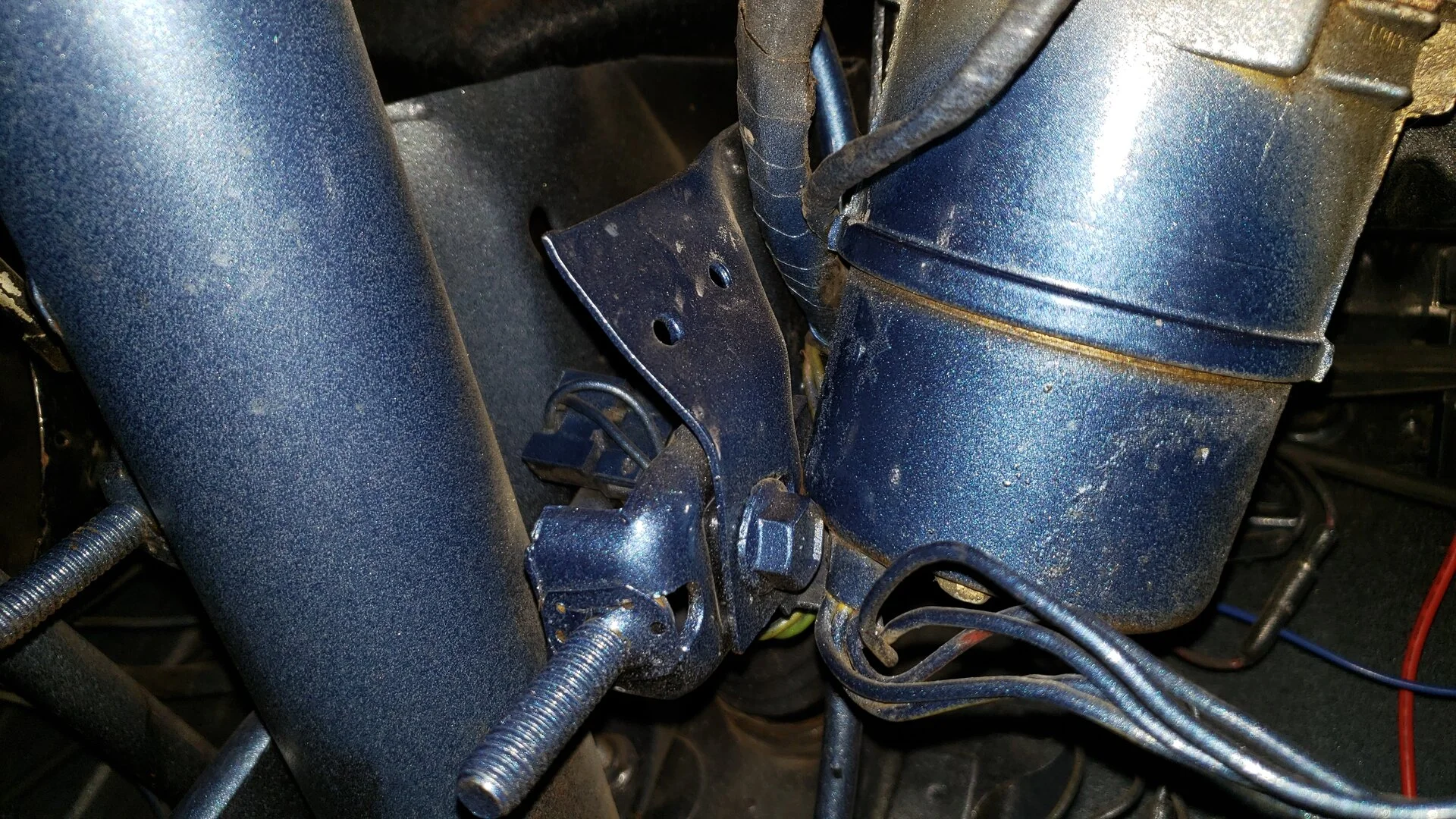

I would say no ,it is not original . I have taken apart a little over 200 mustangs apart and the only time i have seen over spray like that is a repaint . The air cans ,speedometer and wiring was installed after paint . Look at the emergency brake leaver ,if it has paint on the bolts or the bottom of the leaver it is a repaint ,these are always phosphate bolts and the leaver is always black .
You do find paint over the under coat because that was sprayed before the paint ,most everything else was installed after paint

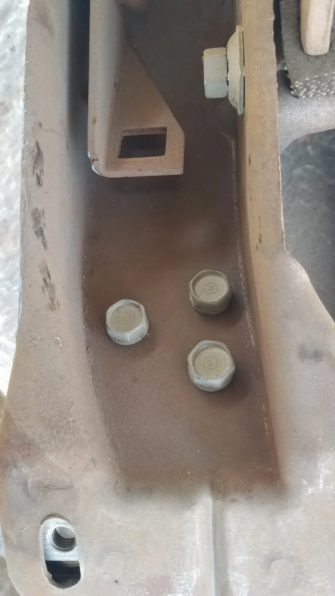

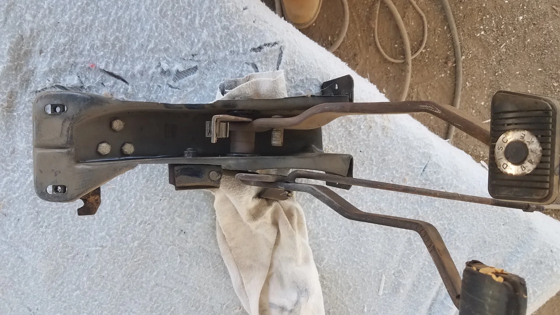

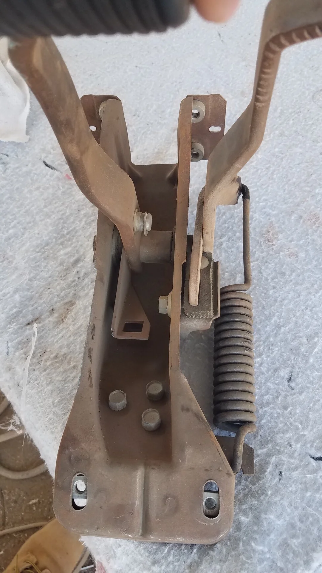

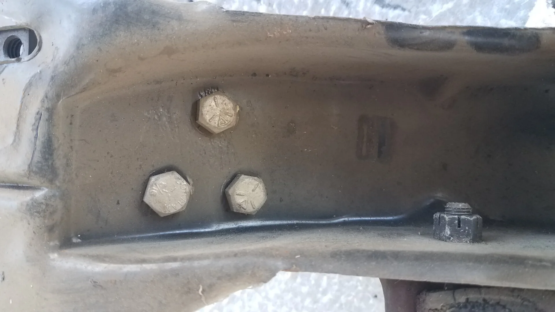

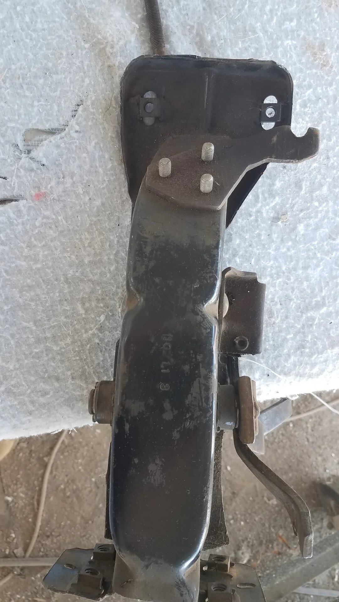

These are two original 4 speed pedal assemblies ,one is bare metal and one is black ,i have seen many either painted black or not . You can tell by the bolts they are both original and neither has over spray . I have several underdash wire harnesses and none of them have over spray ,neither do any of my instrument clusters . You will find different color paint dabs on some of the parts ,the colors were codes so assembly line workers new what piece was needed for a certain car
