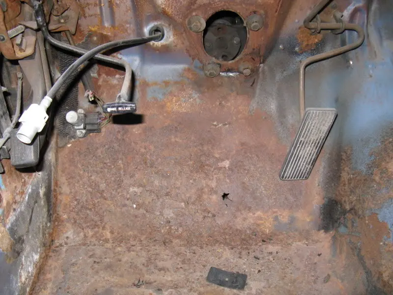

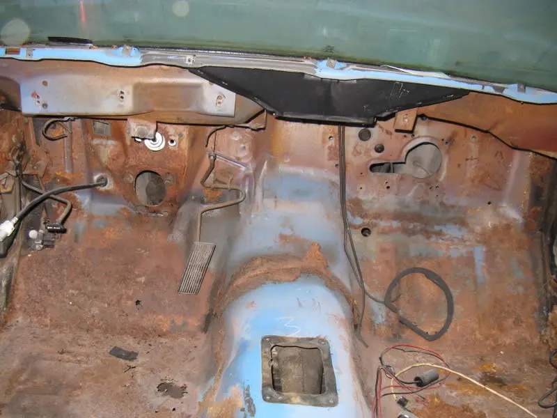

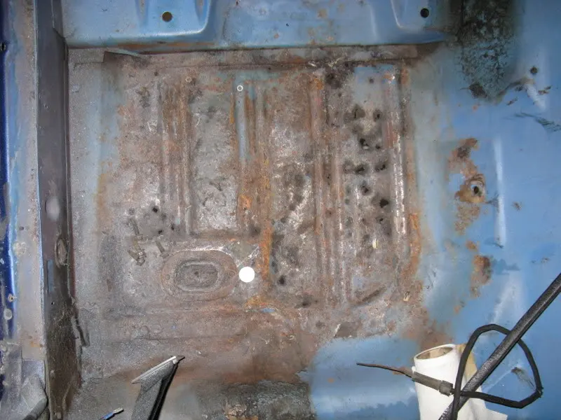

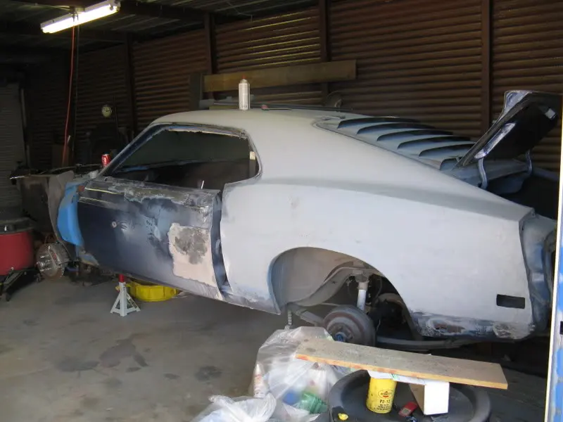

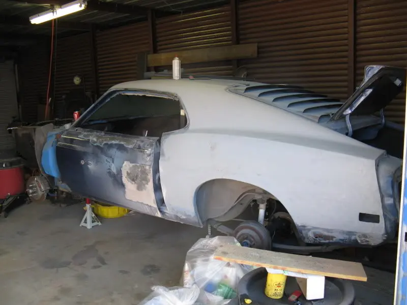

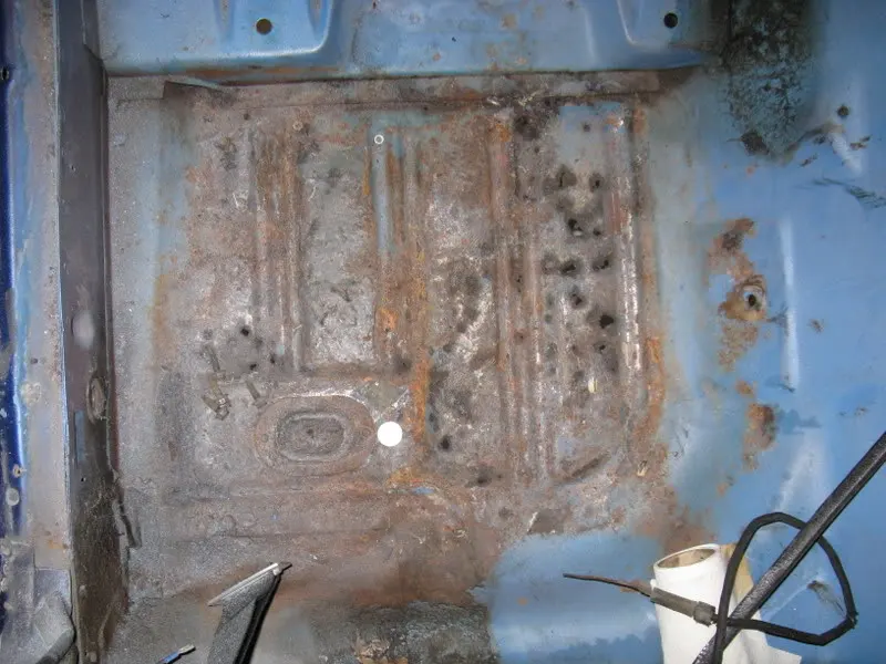

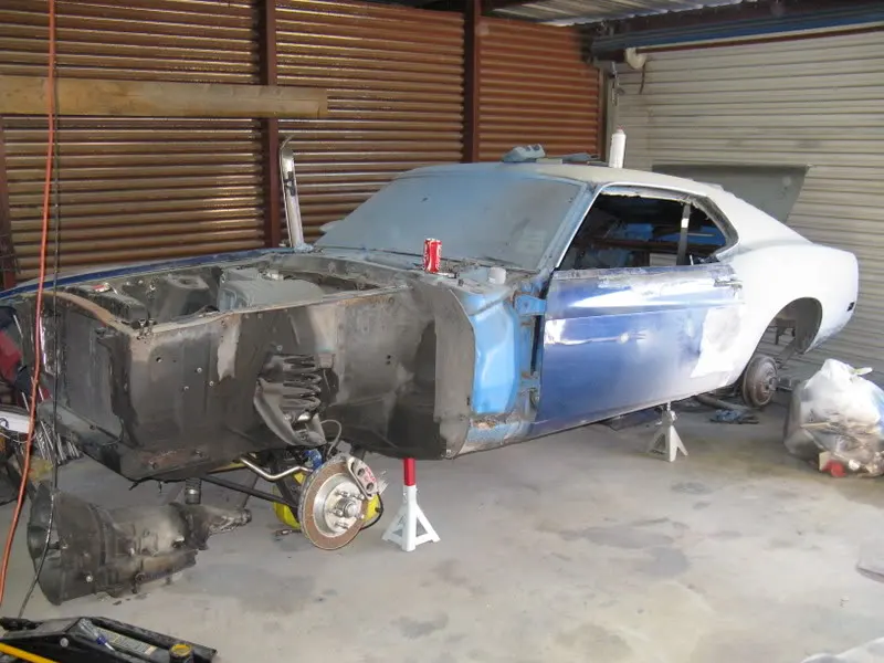

So in the interest of time I've scrapped the major plans I had for the car and have gone back to a bare bones work with most of what I've got type of thing. From the pictures... the goal is to first work on replacing the floorpans that need fixing and the tail light panel which is pretty heinous. I'm not sure if the picture will show the damage on the driver quarter panel, but it looks like gravel. I'm still up in the air about repairing the original panel or cutting it out and trying to weld in the replacement I picked up cheap a while back... not sure i'm up for that big of job yet.
I think I'm planning on sending the doors, fenders, hood, and valences out to be blasted (local shop quoted me about $250)... I don't have enough to have the whole body blasted, so I'll tackle that by hand.

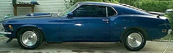

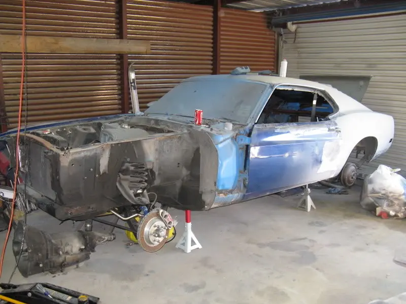

Here's a pic of what is was...

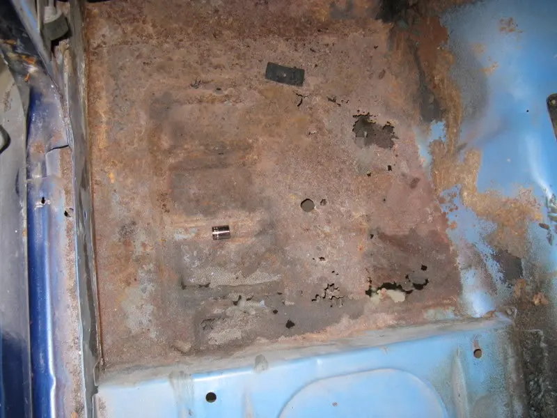

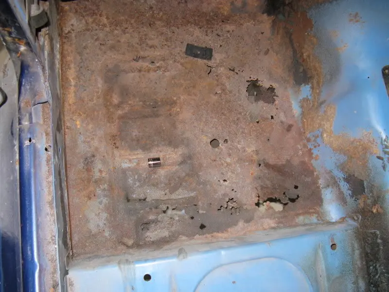

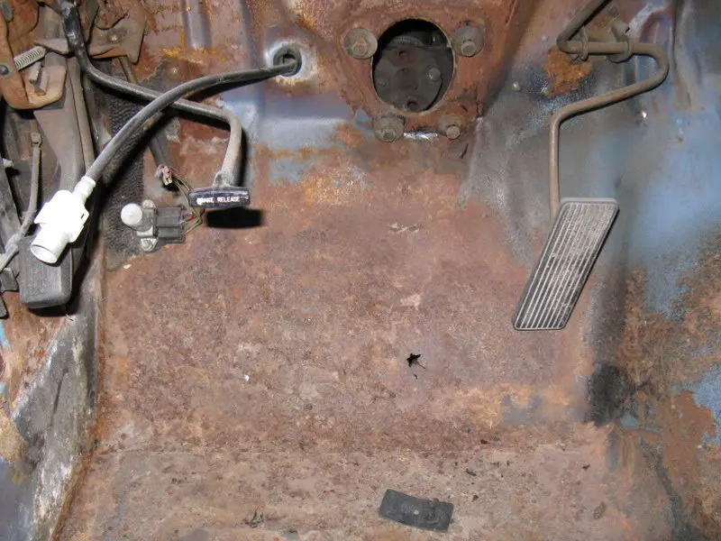

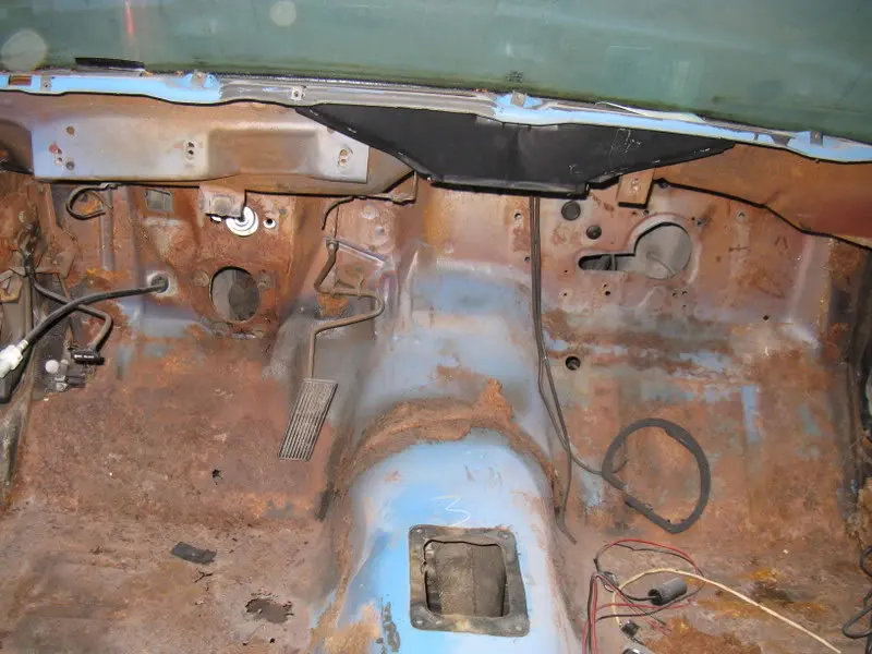

And here is where it is along with some shots of the floor pans
And the rust
So not alot of info... but maybe since I'm finally posting this and the panels my folks bought me just arrived it will help force me to get my butt in gear :)

Here is the plan of attack:
First. Get the car back up on jackstands and weld in braces in doors and through the front of the cabin.
Next, start tackling the floor pans. I've got some full length ones and toe boards. I think I'm just going to section them to what I need and then weld them in.
During (when I get tired of that) or after I will tackle the tailight panel. Again, I think I can get away with just sectioning it and leaving to original top rail from it on the car and patch in the rest.
The hood/fenders/doors/valences/trunk lid will go out for media blasting- this leaves me only one more quarter panel and the roof to really work on taking down. (Still not sure if i should just repair as much as possible and mud it- or tackle replacing the quarter with all the screwy damage)
Next work on refinishing/sealing/soundproofing the inside- get rid of all the surface rust etc and give it a coat of sealer and paint.
After that will probably be getting the body stuff done, light mudding/ block sanding, etc. And then at least a good coat of primer.
Body goes back together or work begins on wiring and minor part assembly.
Next would probably be paint
Finish wiring and begin reassembly. Begin work on modifying / retrofitting EFI and T-5 w/fuel system.
Install Interior.
Finishing items if I have time and money such as: rear disk brakes, side exit exhaust, new hood, MACH 1 foglight grill, etc.
This sound like a pretty decent progression?
