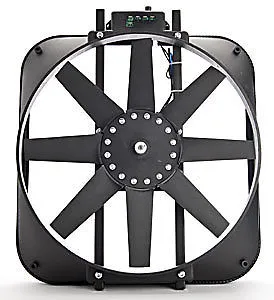

I've had one in the last two cars excepting the current one. Works every bit as good as the Derale it copies,..Built in temp probe, circuit board to accommodate a switched wire option and a AC relay included. How can you beat it w/ a stick?
It's a repackaged old Black tragic 175 /Proform fan and I would be VERY suspect of those cfm ratings. Even Proform says it is only good up to 220hp on a car with A/C and it only draws 13.9 amps. Aftermarket fan manufacturers often use sketchy ways to quote advertized cfm ratings. A 2800 cfm rated fan should cool more than a stock mustang.
Amazon product ASIN B000630IYEView: https://www.amazon.com/Proform-67015-Mustang-Fan-Kit/dp/B000630IYE
With a heavy-duty motor, highly angled blades, and 15 diameter, this unit pulls up to 2,800 cfm of air, cooling vehicles with up to 250+ HP (without air) and 220+ HP (with air).
Your call but on any type of modified car I prefer to use an OEM Ford fan from either a MKVIII, Taurus, or Contour and then a decent controller like the FAL 33054.

Thats the same model I have on mine, wiring is easy, I've had no problems with the fan itself but it needs a shroud, cooling is ok but I would be suspect in stop and go traffic with the air on, I'm going back to stock clutch fan setup when I swap heads and charge up the ac.
