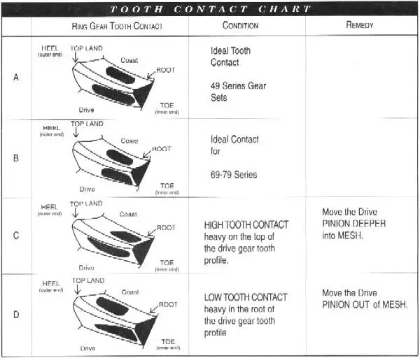

The gears had a lot of striations on the teeth and appeared very rough. The instructions were as expected with center contact desired on both sides of the tooth. However, after many tries, we were unable to achieve the recommended contact. We settled for a center contact patch on the drive side and toe contact on the coast side. The gears did not whine they GROWLED.
Spent some time on the net and found a Richmond instruction that covered the pattern that we had. That instruction said to move the pinion closer to the ring. We did that and, again after many tries, got the Richmond suggested pattern that was drive and coast both toward the toe end. The gears are MUCH quieter but still make some noise.

The biggest problem with this job was the package enclosed instruction for the desired contact pattern was not for these gears. The instructions called for a centered contact on both sides of the teeth - which we could not get. As shown below, the desired contact pattern for these gears is different.
