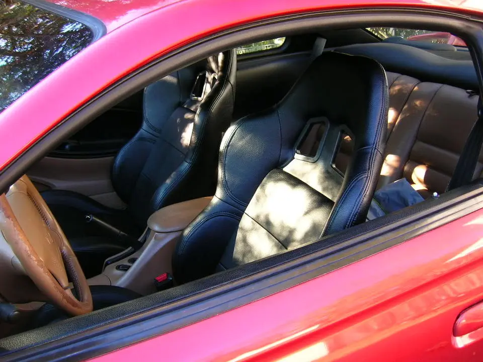

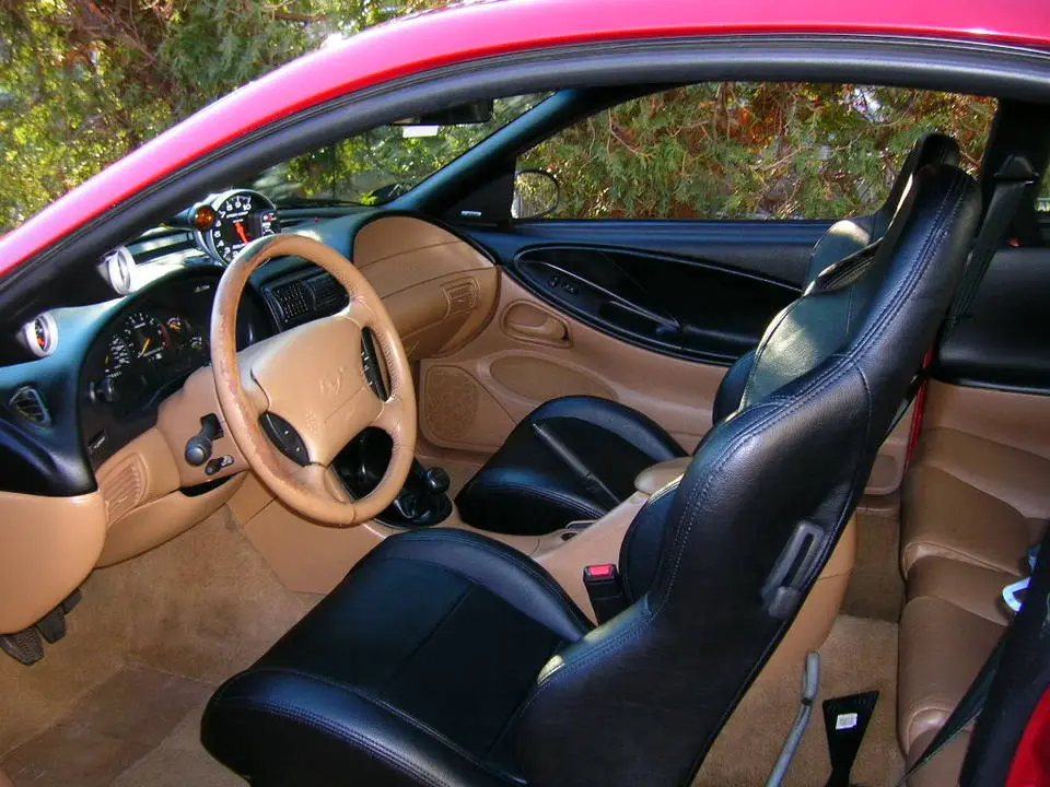

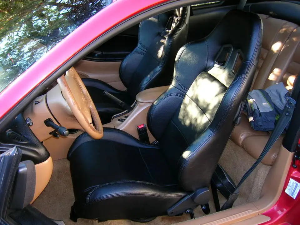

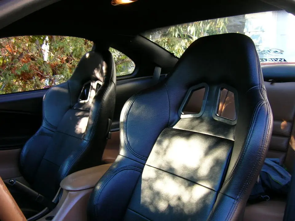

yesterday i spent about 4 hours installing my new jegs sport seats with my buddy...overall it was an easy install as keven mentioned in his thread, but it was a bit time consuming to do the passenger seat....
Passenger-i needed to bolt the stock frames to the back bolts on the new seat using the existing holes, and drill new holes in the frame for the front 2 bolts....then i just widened the holes about a 1/4" on the tabs on the slider that bolt to the floor.
Driver- i just drilled 4 new holes in the stock aluminum part of the slider and bolted the frame right to the seat....the floor mounting tabs were not modified.
The only thing i dont like about these seats is that they are about 1" higher than the stock ones off the floor, and when putting my arm on the passenger seat to turn about and back up, the bolster is in the way of my arm. Other than that i give these seats a 9/10....DEFINATELY a great buy!
Heres some pics:

so it still uses the stock mustang seat rail and u still have the power seat controls looks like
stprorolla49
Oct 9, 2004
1,455
15
39
Fairfield, CT/North Jersey
Dec 27, 2005
  • Dec 27, 2005
yes sir....i just needa make a lil aluminum panel or something to mount the stock toggle switch on cause its just chillin under the seat right now as you can probably see..

Thats cool. Anyways, I'm glad you posted the pics. I have the exact same interior as you (except for the damn click-click box in mine lol) and I wanted to see how the black would look instead of the tan seats. It looks good.
You mentioned it sitting a bit high. Is that comparing it to the lowest position on the power seat? Just wondering.
stprorolla49
Oct 9, 2004
1,455
15
39
Dec 27, 2005
  • Dec 27, 2005
yes..i sit with the seat all the way down unless my frame is broken and i dont know about it.....its amybe 3/4" - 1" higher than stock..they are realy comfortable, and REALLY hold you in around corners
