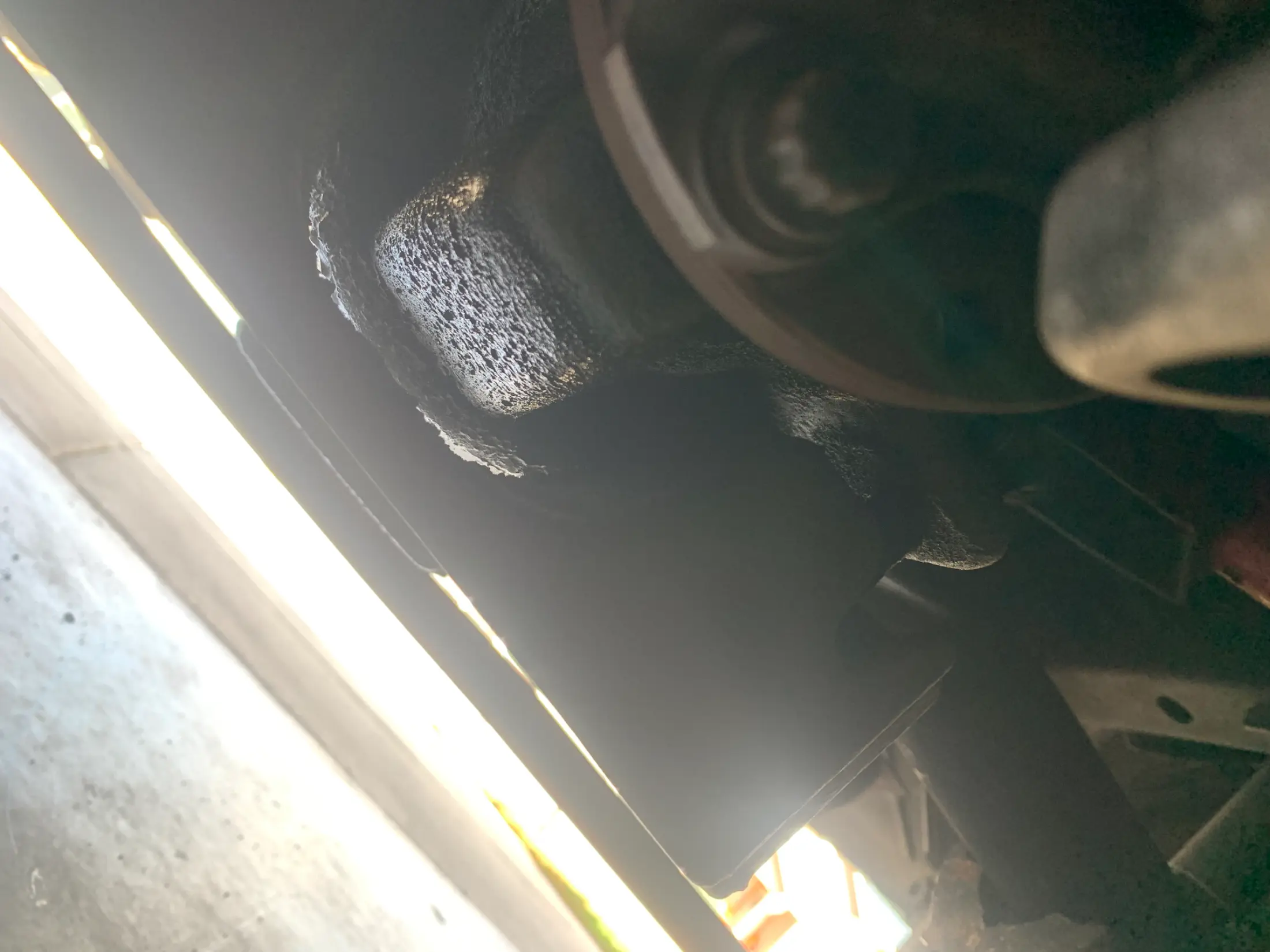

I lifted car. I do notice some rear end seepage. Not sure if it’s comming from the cover or the pinion flange but I did have the pinion flange done anout 2 years back and I belive the cover had a lube locker seal. I belive it’s comming from pinion seal now if the vibration is from there does that mean my gears are ruined? I drive it daily. I remember lifting it few months back this just started . Or adding fluid would fix it of course got to fix the leak.

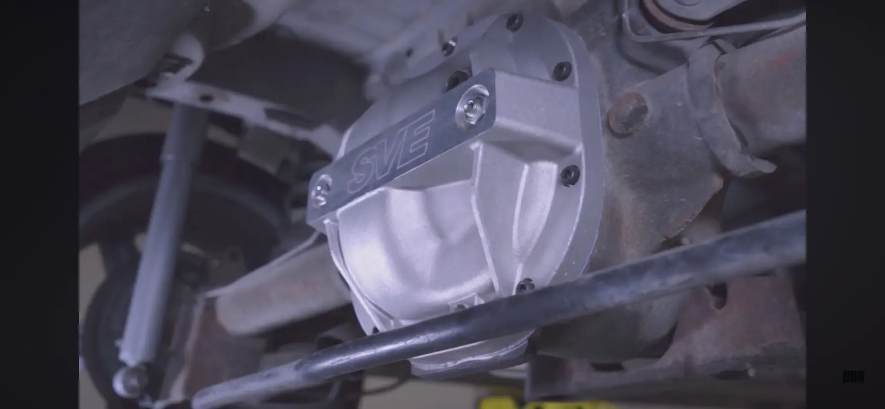

Dosent do it at idel but once I start rolling I hear it. I did lift car and I did have the brake lines touching the exhaust I know that was one of the noises it was soo annoying now I’m looking at the rear end and I see fluid leaking not bad but still it shouldn’t I had taken the rear end 2 years back and them redo the pinion flange not sure if that would cause vibrate but it had the stock fill hole and the sve cover had one should I fill on the stock or the sve cover

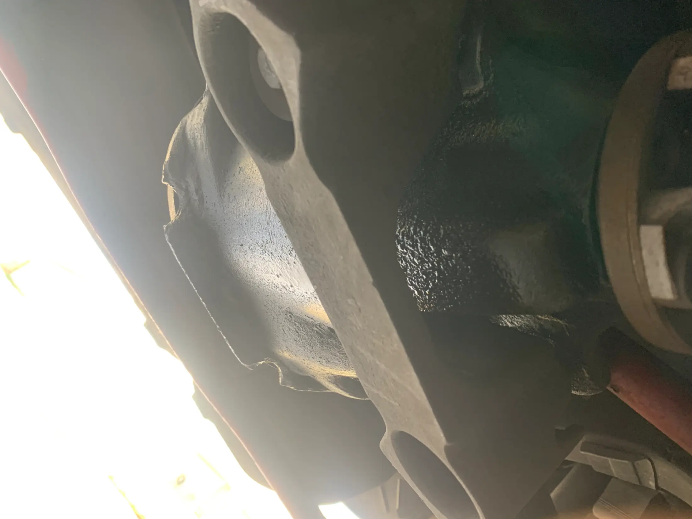

Now I’d like to also add that when I meant the shifter was vibrating I meant the whole trans would shake over bumps I think more then usual now me getting under here I’m seeing rear end leaking I don’t think this was the problem but i know it is a major problem

A leak does not cause a vibration but a vibration can cause leaks.
Is the leak like dripping or a stream or is the area just wet (oil) and dirty?
I would fill till fluid runs out of stock fill hole, prolly easier to fill using the fill hole in the cover, take the stock plug out fill till it runs out.
So I can fill thro the front but take off the fill plug in the back while I’m filling? Also it had a good amount of oil in it. I just noticed the leak it’s not under the car at least I never seen it I just happen to get under the car and saw the underside of the carrier is wet not a lot . I do have a bald tire on the back can a bad tire vibration cause leaking there ?
