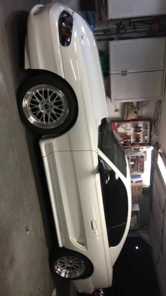

okay you guys probably get the same question but I have a pretty much stock 95 5.0 5speed it has bbk long tubes e cam and cold air intake and a 410 I want to go with the biggest top end I can with the stock lower until I have the money to build the stroker short block the car does have a zex 125 wet shot on it but will also be going with a supercharger and the wet shot will be coming off I was looking at doing the afr 185s with the e cam and 1.7 rockers I have a cnc ported gt40 tubular intake so I was going to get 42# injectos with a calibrated maf and a 70mm t-body would that be too much for a stock short block ? I know I'll need new Pistons
