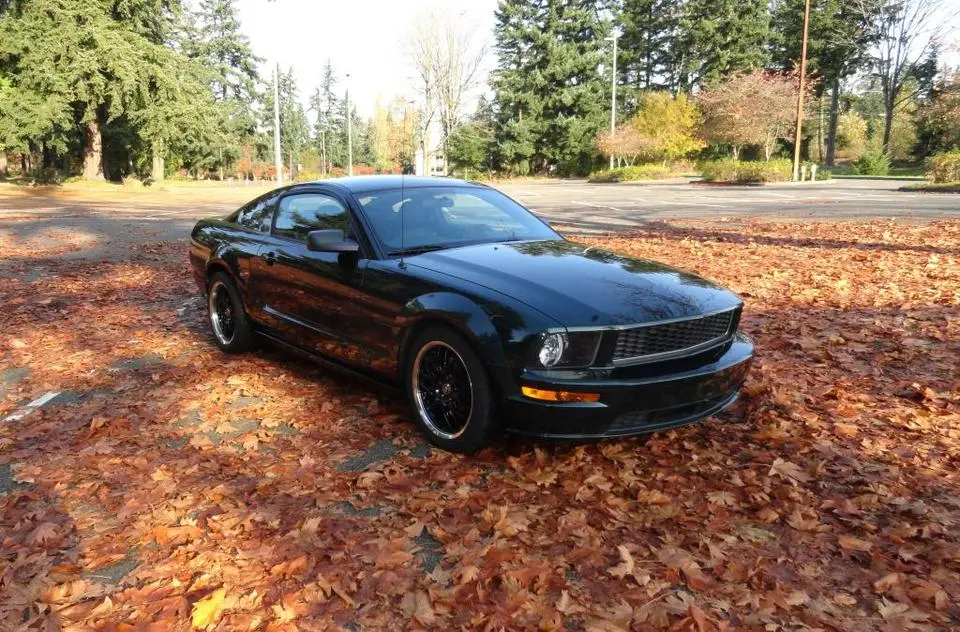

Mostly cosmetic...no spoilers, no ground effects, different stitching on the seats, different look to the instrument cluster/dash and other interior trim parts. Engine got a little different factory "tune". It has a 250 rpm higher red-line. It sits about 1/4" lower, different struts/shocks/springs. At first glance it looks like a plain Jane v-6 model. Has the "Bullitt" style wheels and most important is you can only get the Dark Highland Green paint on a Bullitt Edition. For some bizarre reason you could also get a Bullitt Edition in Dark blue and black. They only made 3 or 4 thousand or so of this edition car for what that is worth.
This is mine with the Enkei wheels. Since this photo I have also tinted the windows which really makes the car stand out.
