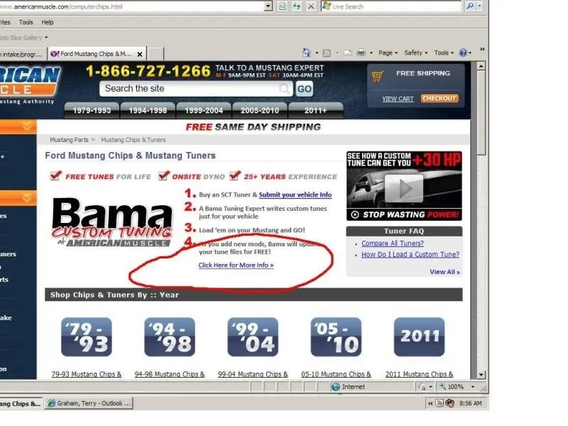

I don't think they can be any more clear than this. (not to mention that it should be common sense really)
Bama Custom Tuning provides FREE tunes for life on our SCT custom tuners & chips and Diablosport Trinity custom tuner. Any time you make a new modification that requires a re-tune, Bama tune technicians will write you a new one for free - just contact us!
How to Get Free Tunes For Life:
1. Purchase a Custom SCT SF3/X3, Livewire or TSX tuner or Diablosport Trinity Tuner
2. Tunes are written just for your vehicle by the Bama Custom Tuning division
3. Your tuning info will be kept on file.
4. Your new tunes will be emailed straight to your home computer.
5. When you order a new performance part, contact us to order new free tunes.
6. Repeat - For Life!
Offer valid for customers who originally purchased an SCT or Diablosport Trinity custom tuner from AmericanMuscle.com. BamaChips customers who purchased an SCT or Diablosport tuner, or custom tune files, are also enrolled in the Free Tunes for Life program for continued support by Bama Custom Tuning. Please contact us when you would like to order new free tunes, at (888)226-9764.
Only the original car tuned for device is eligible for the Free Tunes for Life program. A new car will require you to buy back in to the Free Tunes for Life program. Please contact us at (888)226-9764 for more information

Ateup, where did you find that at? I've been on their website a few times looking at programers and CAI's. All I have ever noticed is they advertise "Free tunes for life."
It could have been right in front of my face and I missed it. I have always understood it as you get free tunes as long as you own the programer until all of this.

It's at the circled link:
