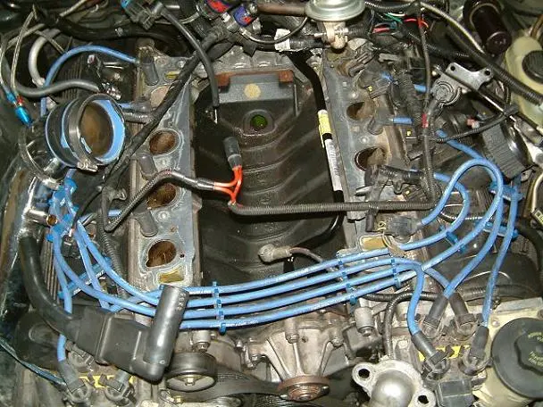

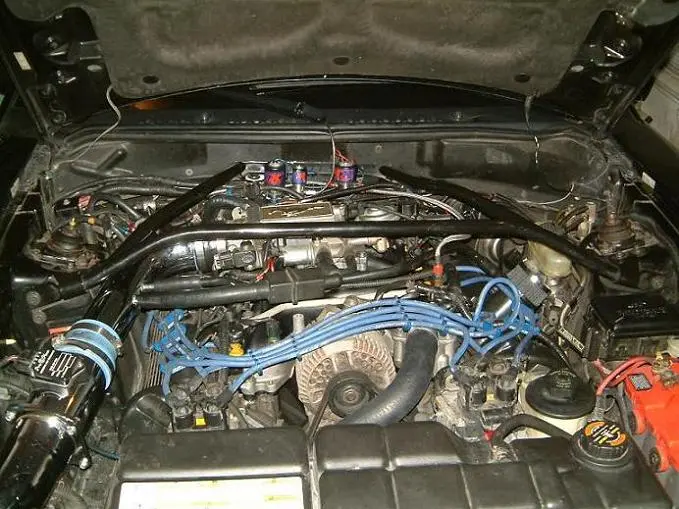

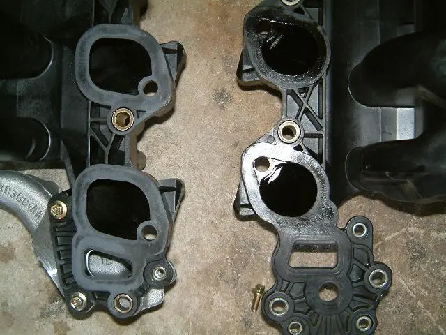

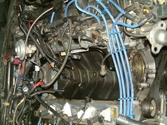

Well, I just got done with the swap and I must say it was not as bad as I would have thought. Everything went together just fine with no leaks. The only real pointer I have to give is to make sure to use a great deal of RTV around the ports facing into the valley of the block. Still the only real issue I ran into was getting the stock coolant tube unbolted from the back of the head. Because it has two bolts that run right between the firewall and the back of the driver’s side head that just made it hell to get out. :bang: But after everything is said and done, I am really happy I made the swap, and would highly recommend it. There is a huge SOTP difference in the power ranging from about 2,500 - 5,500 RPMs; witch really helps out because that’s where the stock intake just seemed to run out of breath. Here is a list of all the parts I used in the swap.....

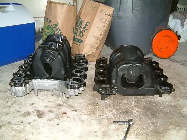

the two intakes

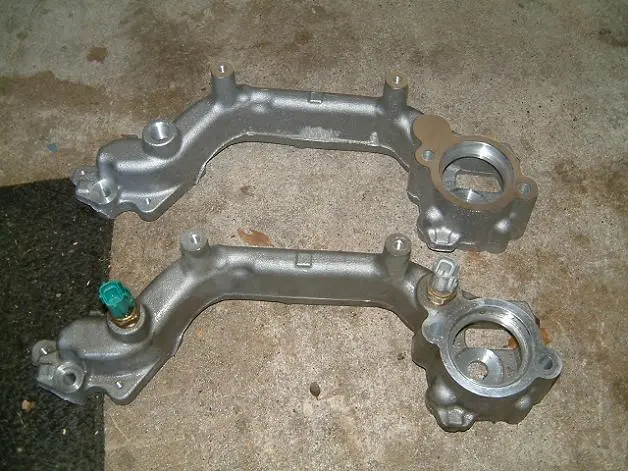

Was there any issues with swapping the crossovers? I have a NPI intake with the aluminum crossover and would rather swap it than tap the other one on the PI.
This was exactly what I did when I did my headswap. I had the aluminum crossover from the cracked intake recall. I just unbolted it from the non-pi intake and it bolted right up to the pi intake. I didnt have to touch any of the sensors or worry about tapping the new one, since they just swapped over.
yeah, if you can that is the best way to do it.
