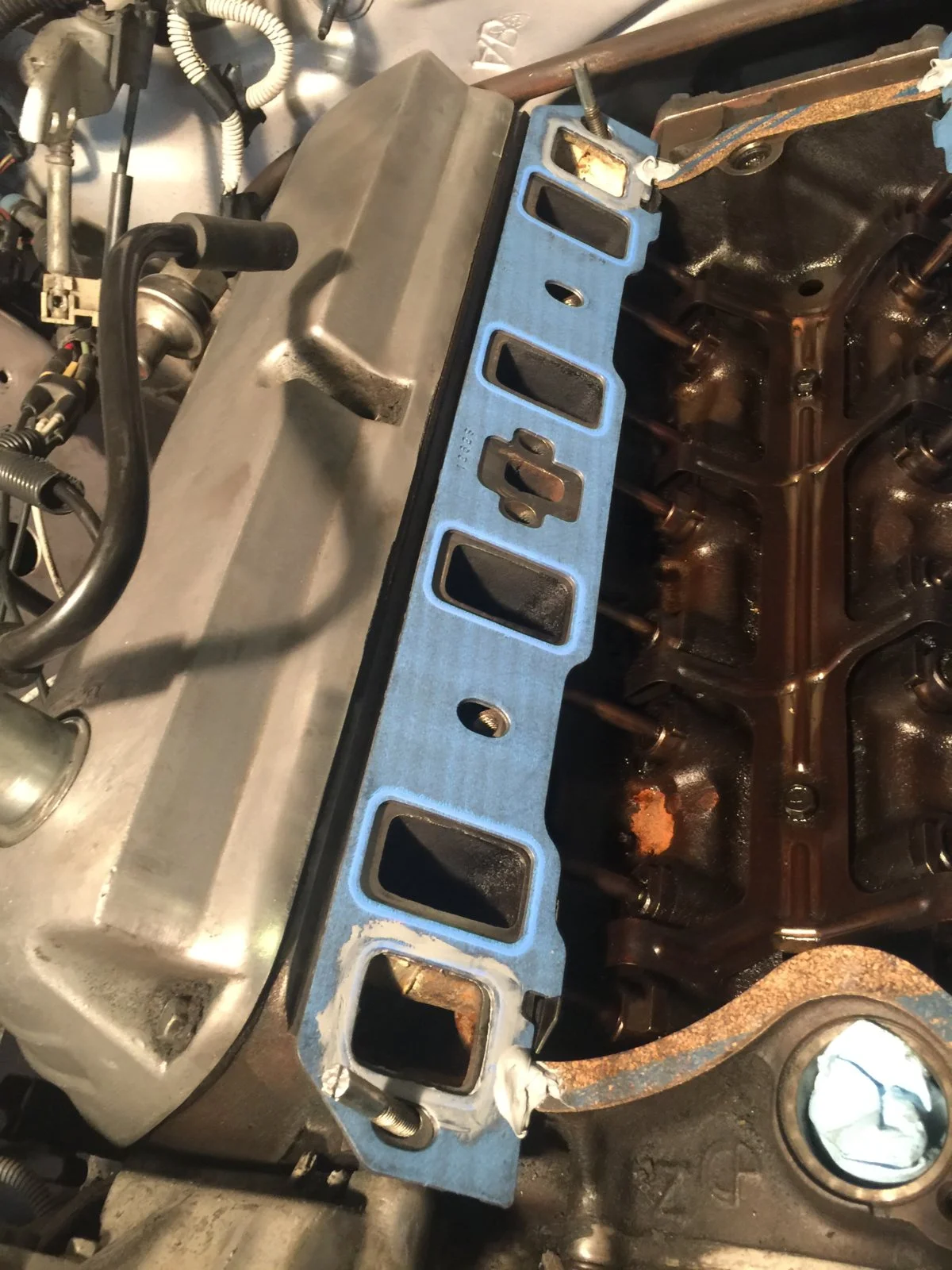

This was gasket set up before lower intake was out on...everything look ok? I did put some red permatex on top.of the cork end gaskets.

maybe the gasket shifted during install? I had new bolts for the lower intake, so i used the old bolts to properly mount the lower by cutting the bolt head off and slotting the head for a flathead screwdriver. worked like a charm and no leaks (and it was my first time doing it)
  • Informative
Reactions: Olivethefet
Personally I use a thick bead RTV (right stuff) instead of cork but a lot of people use the cork with no issues.
You may need to start investigating with some disassembly.

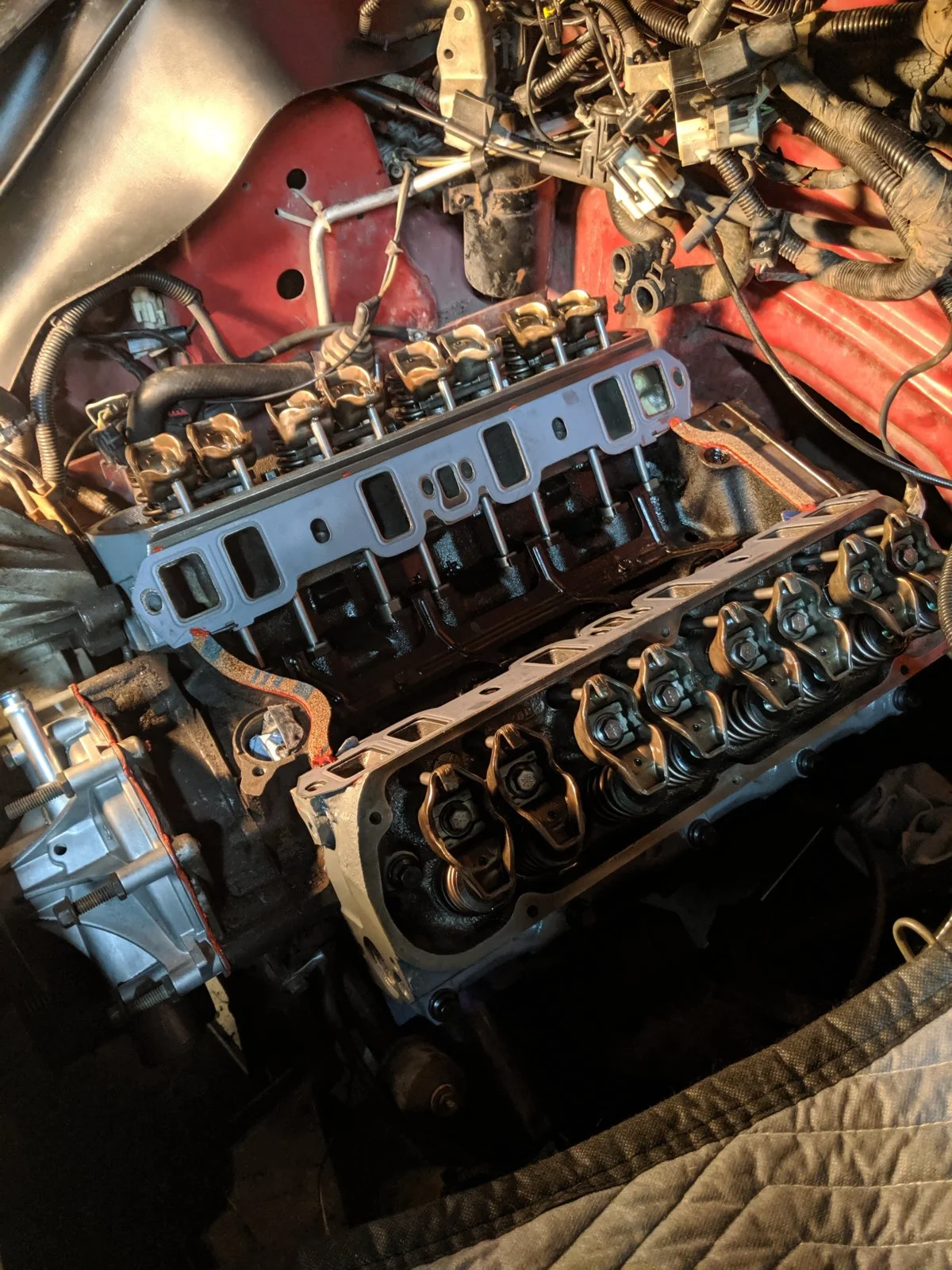

So l finally had a chance to pull the upper this evening and the upper gasket looked great (no surprise here).
I put my torque wrench on the lower bolts and man were they loose. I was able to turn all 12 bolts when set at 16 ft/lb. I then moved up to 25 and they obviously tightened alot more.
So my questions are:
1. Could these very loose bolts (front and rear most were the loosest) cause coolant to be getting into the exhaust?
And
2. Is there any chance that tightening these up to spec will be okay, or should l remove the lower intake and use new gaskets??
