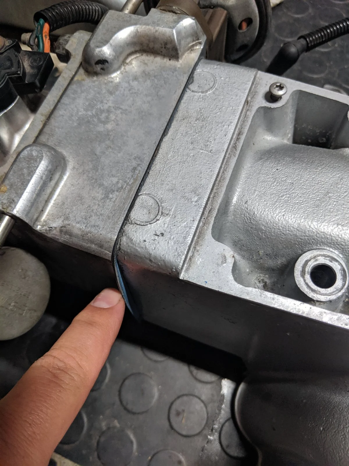

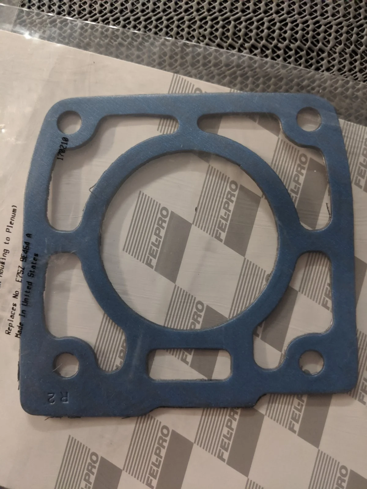

Another question: is this the correct gasket to go on the throttle body or do l have the wrong one?
I didn't use any RTV on it when l installed it.

I am questioning the TB gasket as all the online pics l see of the replacement gaskets for the 70mm TB don't have the small rectangular hole.on the bottom like the one in my photo does???
K...had some coolant leak out upper intake when l took it off and just wondered if l was getting a coolant leak from the TB into the mani which lead to the exhaust smoking. I did install a GT40 intake. My stock Iower/upper intake had a 70mm TB installed on it when l bought it, and l removed this and re-installed this on the GT-40 setup.
