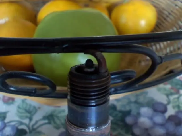

ok well i was finally able to get some pics of the plugs. only bad part is that i had to take the pics with my phone cuz my battery died on my digital camera
background info: car has 86K on it and these were the factory plugs i was removing
plug from cyl 6:
plug from cyl5:
plug from cyl3:
the rest were just a deep red/rust color
the majority of these plugs took some force to take out. however the plugs in cyl4 and 6 were so loose you could just remove them with your hand :eek:(if possible)
the car has a misfire at the moment like i have mentioned earlier. it has not gone away yet so my hunch of it being the computer is out the window. the culprit could be the gas but i am not too sure just yet. i filled the car up with 89 after doing the plugs, i will try to put in 93 the next time and see if it goes away. otherwise i have a suspicion that it could be one or two of the COPS. they didnt look too great. i might have exacerbated the problem by removing them because there was a hint of a misfire prior to the plug swap
That gap looks huge on those plugs you removed...

while i was gapping my new ones i noticed the large gap in the old ones as well. i used my feeler guage on the old ones and it seemed to me like the old plugs were definitely gapped larger...i will go measure them right now actually
