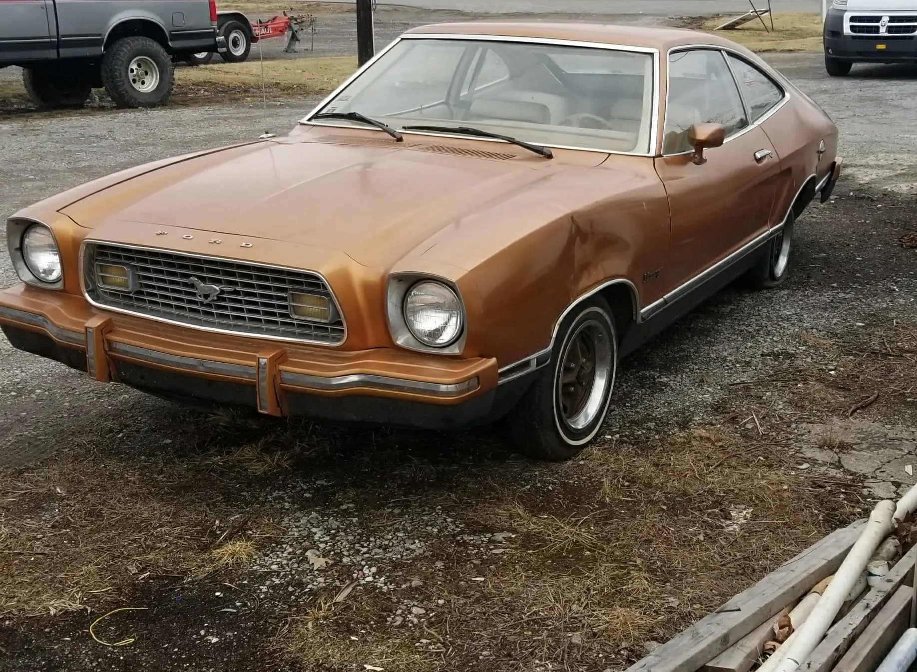

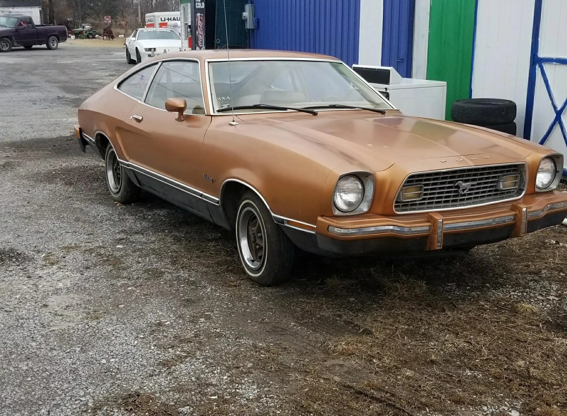

So I just got a 74mach1 (sorry for the incorrect for the incorrect title) a friend of mine whose had it maybe a month but never had time for it so his loss, my gain. Well the guy he got it from said it had the gas drained and then parked for around 20+years in his garage. My buddy threw a battery in it just to try and turn the motor over and see if it was locked up but it turns. Was just wondering if there's anything specific I should look into before trying to actually fire it up of an external tank.
I'm super excited about this car as it's my first true classic.
Thanks I advance for any and all advice or info.

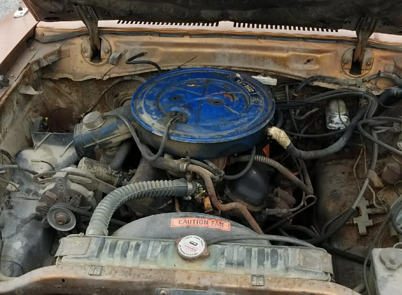

Congratulations! Change the oil and check coolant level before you try to start. I usually pull the spark plugs too and check their condition, replacing wires, cap & rotor, etc. if really bad. That part's not mandatory I guess.
What I've almost always found on my new-old-cars that have been sitting is that a fuel pump that's been left to dry out is usually shot, so not bad to plan on replacing. Just to get it to start, you can bypass the fuel pump and just fill the carb float bowl, even if the fuel pump is bad.
If you have the skills, I'd pull the top off of the carb and see if there's a lot of varnish or junk in there. The carb almost always needs a rebuild in my experience - definitely check that the accelerator pump diaphragm isn't completely broken and leaking. That'll leak gas onto the intake manifold. That's a good time to put some gas into the float bowl and check that (when you press the gas pedal / activate the linkage) fuel comes spurting out of the accelerator pump orifices into the venturi. If it isn't, you can drizzle a bit of fuel into the carb and see if you can at least get it to fire. Make sure the choke is working - it probably isn't so you can adjust it to where the blades are open maybe half-way, for testing purposes.
If all that works, give it a go. Rebuilding the carb isn't hard, and fuel pumps aren't very expensive. My advice above isn't complete, just enough to let you give it a go without potentially causing any extra damage. Then the real fun starts with determining what else is wrong. :-) I mean that seriously, I love the hobby and resurrecting one of these old classics.

I don't think these were interference engines, but I could be wrong. The gear going bad was a super-common failure as it's basically made of plastic (for noise suppression). I've had to replace mine, and just about everyone else has (definitely get a steel one), and I've not heard of a case where it damaged something else. ymmv.
I believe it is an interference motor not 100% sure tho. I have a friend with a shop whose looking at it for me. He's already got the metal gear ordered and a water pump. I also went ahead and ordered a carburator, fuel pump, fuel filter, ignition coil, plug wires, car and rotor, and new belts. I figured that's be a good start to getting the motor going.

That does sound like a good start. You'll probably also want to do the distributor points (a 74 should still have points) and when doing the water pump, there's a better-than-average chance the rear thermostat housing threads will be stripped out. You'll want one of these, and the correct bolts since the old ones will likely snap in half, on hand.
https://www.partsgeek.com/gbproduct...I7ICh3tkAbaEAQYAiABEgIcwPD_BwE&ad=47362750812
And since it's such a pain in the rear, just change the thermostat while it's apart. All that has to come out for the water pump to be replaced or the timing cover to be removed.
