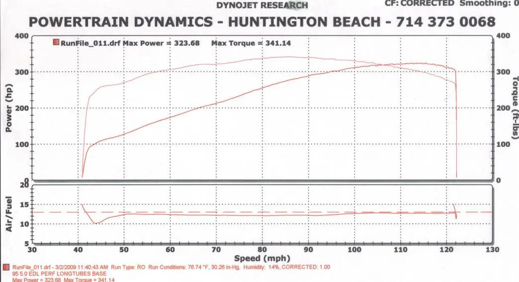

went to my tuner so he can tune my setup......i made 324/341...ill see if i can upload the graph.....we could of got more power bumping up the timing but we left it at 33 total....what do you guys think?

HERES THE GRAPH GUYS......peak hp was at 5800 rpm.....exactly where i wanted it:hail2:

hmmmmmm.....im wondering if changing to an eddy rpm II, a 75mm tb and upping the timing from 10* would put me around 350 rwhp? dont think i would try it but you never know.......alot of you guys dont think its possible with a 302....i might try to prove you wrong :)

I'd already figured the rpm out earlier Grady. Here's what I said in a post on corral.net:
There's no rpm scale on the dyno chart but that doesn't matter 'cause I've worked it out. The HP and TQ curves cross at 5250rpm which arrives at 106mph so the gearing is 49.5rpm/mph.
Peak HP is at 114mph (5650rpm) and peak TQ is at 86mph (4250rpm) with the rev limit coming at 122mph (6050rpm).
Not only are the peak HP/TQ numbers impressive but there's at least 300rwtq all the way from 2800rpm to 5650rpm, so there's useable power over a wide rpm range.
