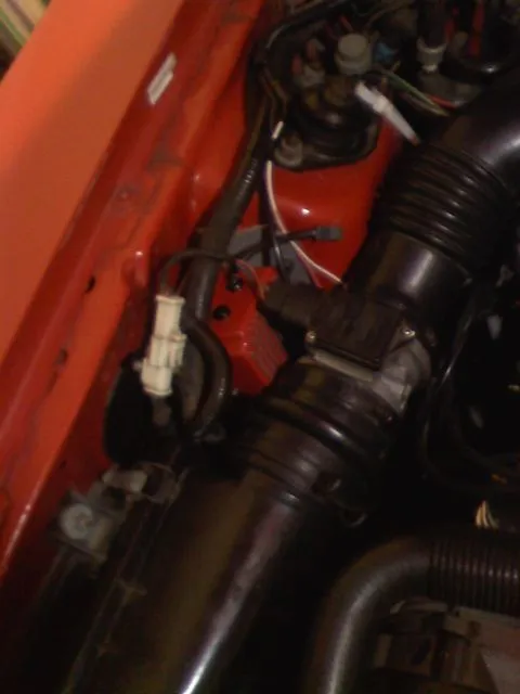

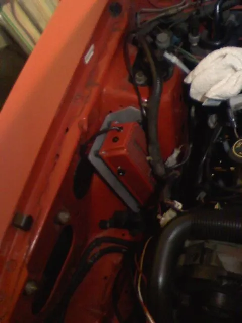

Just installed MSD 6AL
I figured I would post these pics for the guys looking for a place to mount their MSD ignition. I used the pre-fabbed bracket sold my Summit especially for fox bodies (SME-2802) and the harness to connect the MSD unit to my EFI harness (MSD-8874). It all fit in like a glove and allowed me to hook my stock airbox back up without any mods, just relocating a couple wire harnesses. I was pleased with the results, can barely see it. I'm hoping I won't have to move it once I get and install a turbo kit, but the downpipe might be too close to the ignition, we'll see. I know it would be easy to put it where the battery is but i'm really not trying to move the battery if I don't have to.

Looks great. I have a MSD unit I have never installed. I'm deleting some components under the hood and then I am going to put it in. Just make sure it isn't getting wet or that it is getting too hot.
