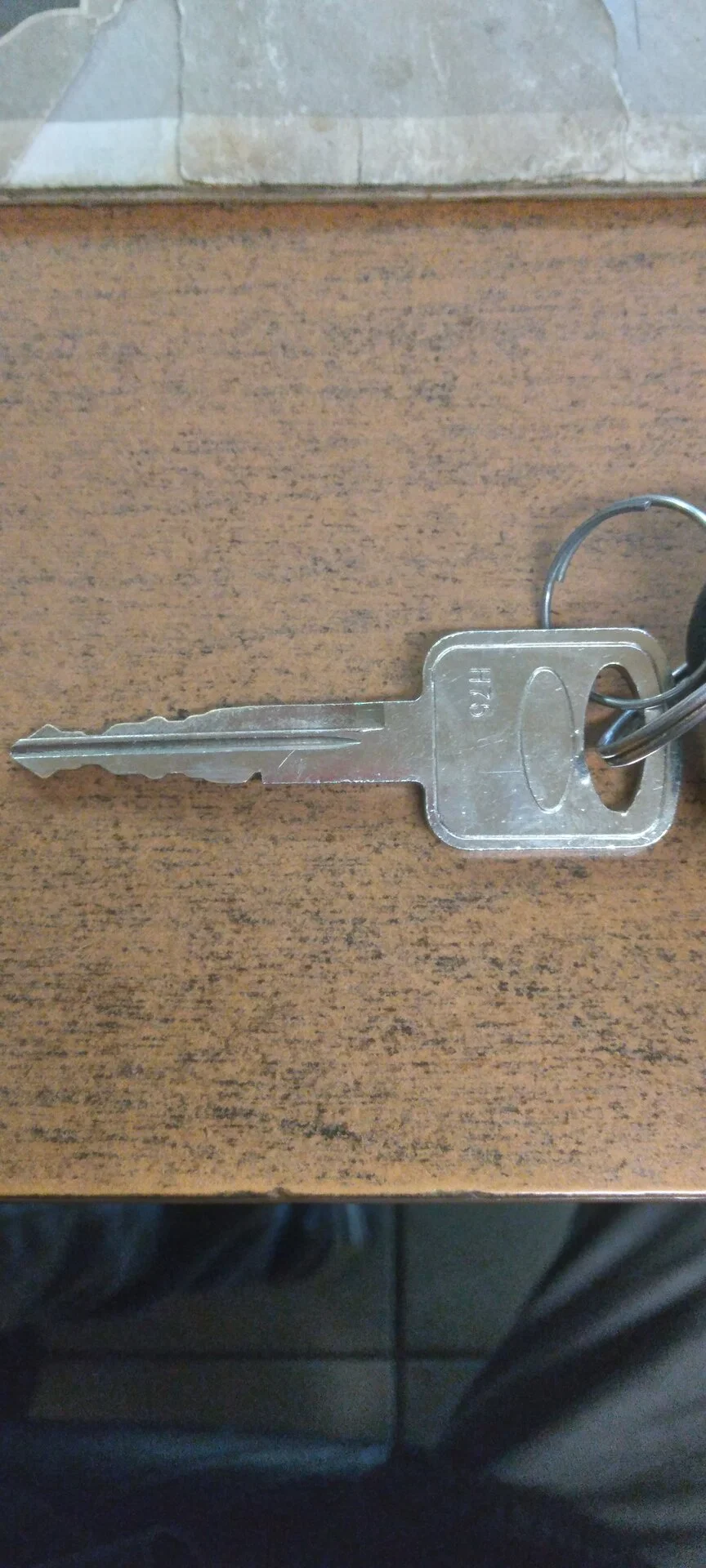

I have an ignitionand key question and need some help does the 96 need a chipped key the key i got is a standard key and the car won't crank
My 96 Convertible has a chipped key. I don't know if they all had them, but mine doesThis is the key I got with the car and yes the theft light blinks fast when I turn the key and the car doesn't turn overlike no power to the starter but all lights come on as they should

Thanks General you are correct as I have discovered but I purchased a new lock cylinder with keys and the locksmith is coming out tomorrow to program#1 the key in the pic will not start that car.
#2 if the 'theft' light comes on or blinks you have the anti-theft option, I don't remember what year they became 'standard' equipment.
#3 call another mobile locksmith, they can copy that to chipped key blank and program it right in your driveway.
