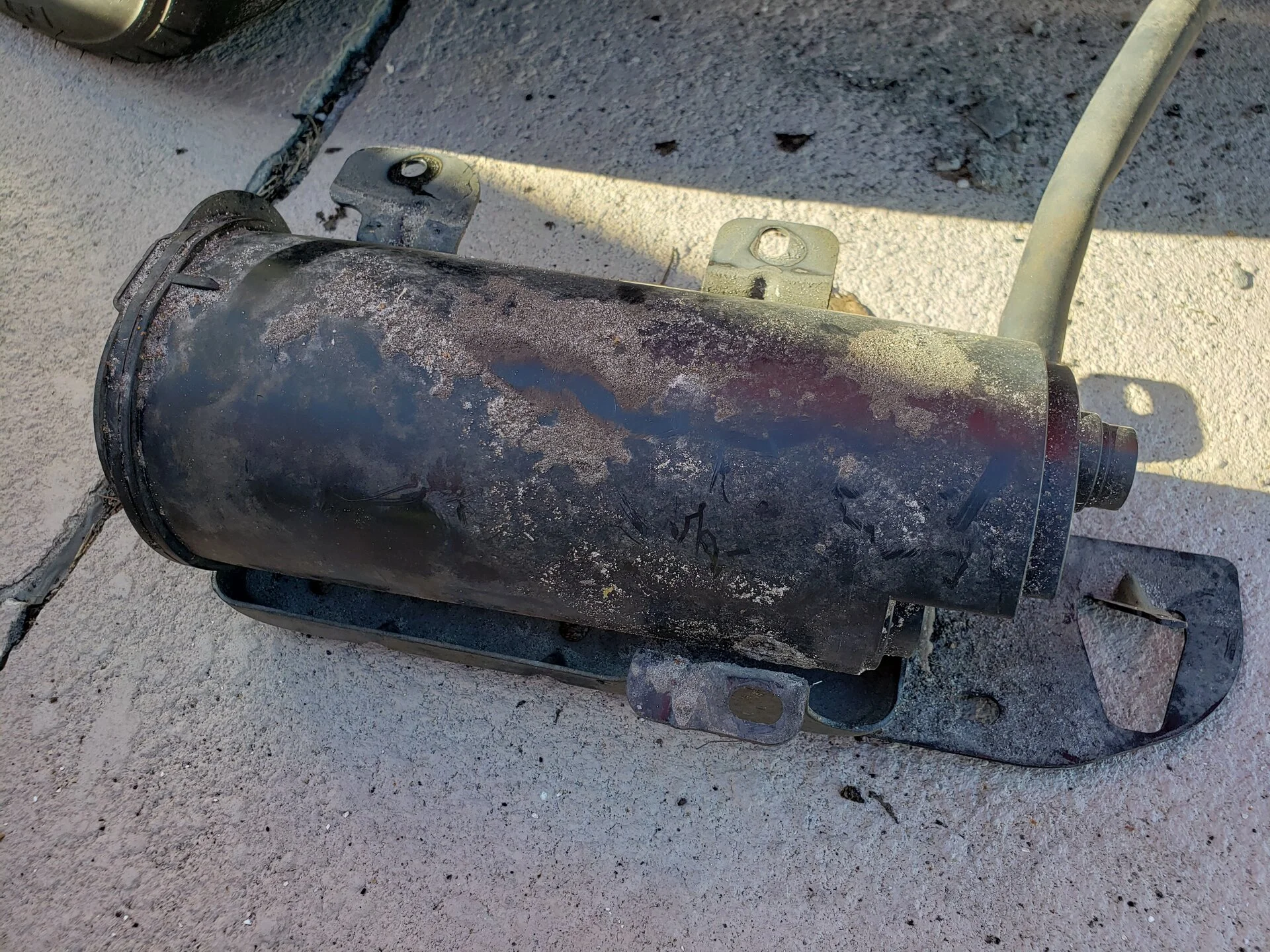

Unrelated but there are no lines connected to this cannister except one that goes to a solenoid. Can I just cut the line and trash the component? Will it throw error codes?
Its behind the drivers side rear wheel. I cant find it anywhere in a haynes manual. Honestly looks like some kind of legacy fuel emissions probably fuel vapor charcoal cannister but there isnt anything from the fuel lines going to it. Maybe it was just disconnected. I can always disconnect it at the sensor and see if any error codes pop up.
