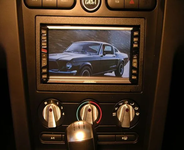

I installed the Eclipse AVN5435 & love it. I put the GPS antenna on the dash directly underneath the mirror. It sits up against the glass, gets great reception for the nav and it is almost invisible (small antenna). My shaker system amps and speakers work just fine, just had to use a premium sound wiring harness.
As far as your satellite antenna, I don't know how big it is, but I have seen mustangs with it between the two rear speakers.
