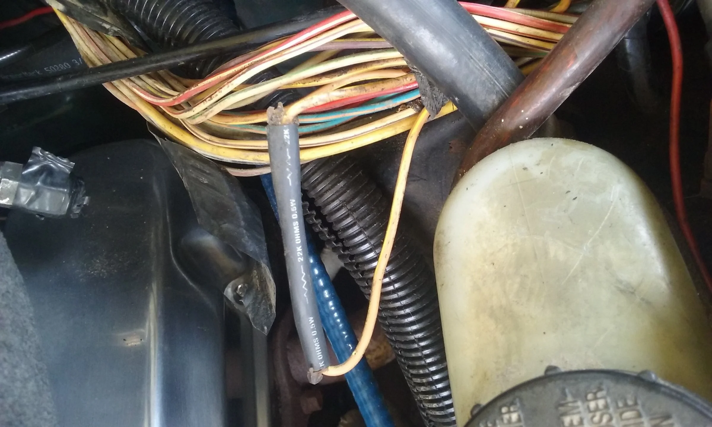

In the diagram, you can see pin "5" on the TFI connector splits into three paths; one to the tach, one to the coil negative, and one to the ECM pin "4"- the IDM, or Ignition Diagnostic Module. Notice it goes through a big, fat 22,000 ohm resistor. That's a fairly big resistor. Long story short, mine was completely fried. With that resistor burnt out and allowing no current through, the ECM wasn't seeing a return signal from the coil, and so assumed the worst, and threw a code 18. Here is a picture of that resistor:
It's pretty hard to miss. Anyway, as far as I know, Ford didn't foresee this thing ever going bad, as it is a permanent part or the wiring harness. So, replacing it means cutting it out and splicing in a new one. I went to the local electronics store, and picked up one of these:
It's a new, basic, no frills 22K ohm resistor. It's a $2 part. Try fixing a diagnostic code for less than that! I went with the 2W variety, but I'm no electrical engineer, so I can't say what the effect of going bigger or smaller would be. What little I know about wiring tells me that you probably don't want to go too small, and going bigger probably couldn't hurt (in terms of wattage. Going with a different resistance value than the original 22K ohm risks burning up wiring or even the computer). Replacing the resistor did the trick- no more code 18.
