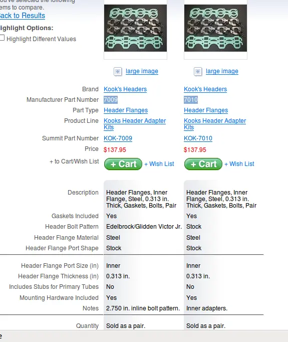

I need to get an adapter plate for my Kooks headers that are going to be mated to a set of Edelbrock Performer RPM heads (6025's). I would assume that the 7009's are the right ones because it says "Header Bolt Pattern Edelbrock/Glidden Victor Jr.". Now, are they talking about the bolts that go into the head, or the bolts that go into the header?
If I post the link I don't think it will work since I'm using the compare function, so I've included a screenshot so you can see what I'm seeing.
It looks like the two pictures are exactly the same, so I don't know...
If someone could clear this up for me I'd appreciate it. I'm sure if I got the wrong one Summit would exchange it, but I don't want to deal with the extra down time.

Mike I think you want the 7010, stock style. Measure the distance beween your header bolts on your head, the 7009 references a 2.75" which is wider then stock ports.

You're probably right about the 7010's. The way that the description was worded was just confusing. The heads do have the stock header pattern. I didn't realize that there was an Edelbrock/Stock config and an Edelbrock/Edelbrock config.
