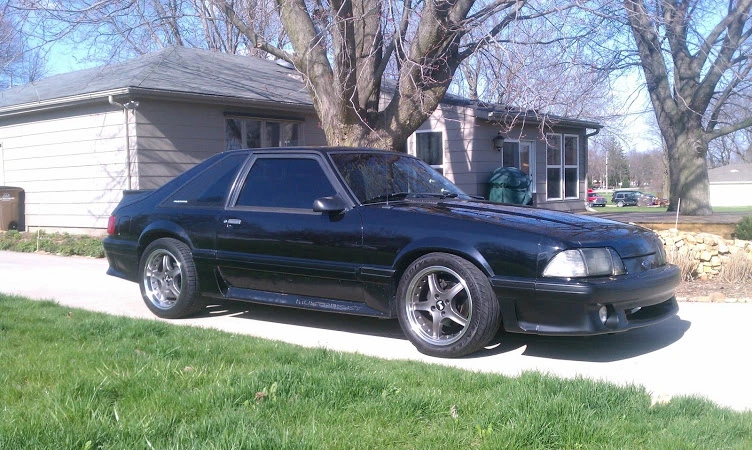

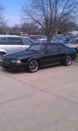

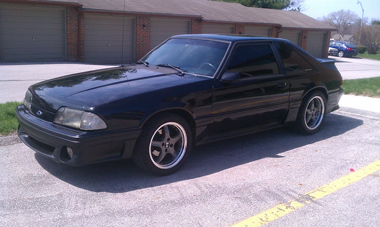

From this...
To this...

BTW, it does look nice!
It does look real nice.
I hope mine will look just like yours, assuming we have the same Eibach set, once I get a set of 17s on it and put the rear springs in.

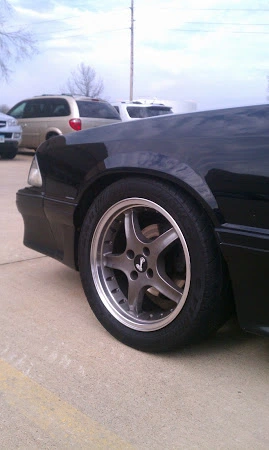

I don't remember what Eibachs I have, yellow in color, but they are 1.5" drop springs. I love them. The front isn't bouncy, but I do rub on my inner fender wells. I would just remove them, and undercoat my fenders, but I am going to be tucking my wires one of these weekends, and would like to keep as much water/dirt out of there as possible lol.
If/when they start to make any noise, I will just add the iso's :) and thanks 1200gt. It came out as I hoped it was going to.
Car looks good. How does it ride now with so little spring up front?
Quite surprisingly, it rides very well. No bounciness at all, feels more firm than the OEM springs, but I do have the occasional rub when I hit a dip. I am not hitting the fender, so I figure its because I am running 245's up front on a 9" wheel, and its hitting the inner lining of the fender well.
Was that a 4x4 mustang you started with? :p
Car looks great lowered! I have never used isolators and never ever ever had a problem with noise. I always change the springs like MFE92, usually 15-20 minutes a side and the whole car front and back in about an hour ;)

Thanks man, really appreciate it!
It was pretty much a tonka truck before lol. ALWAYS irritated me, and I wasn't going to lower it this year, but I found a guy selling a slightly used set of Eibachs for $100. I offered $70 and he took it. I couldn't beat that at all.

Just an update, but I am now having NO rubbing problems! Lifted the front of my car up this weekend to change out my thermostat, and say that a part of my fender lip was bent down. Every bump I hit, it would rub against it. Well, I bent the lip back in place, and now I can hit a (small) dip and have no contact! Woot! lol
