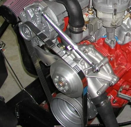

you can use standard rotation water pump on the late model (5.0 not town car, T.C. is already standard rotation), you just have to reroute the belt. Many people are running this, I have mine setup this way just not in the car yet.
