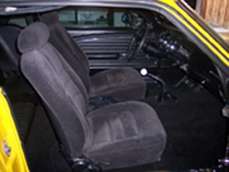

I have '94 Mustang seats in my '68 - previous owner did the installation. I believe all you need is the rails from your Mustang and bolt it on the newer seat bottom frame. I am not sure if there's any drilling involved.
<img src="http://forums.stangnet.com/attachment.php?attachmentid=32135&stc=1" />

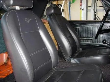

I just installed a pair from a 2002 Mustang - I think they came out looking pretty nice. Installation is straight-forward. Just drill new holes in the seat base to accept the original seat tracks, then bolt everything back in place.
