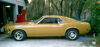

I thought I'd chime in since nobody seemed to answer your question about the NPD springs. I've got NPD's mid-eye 5 leafs on my Mach. They're stiff, but not ridiculous and my car sits pretty ok... I'm still thinking of lowering it but I really want to let the suspension settle after a few miles (which it just hasn't gotten yet). Anyway, my front suspension has the GW negative wedge kit with 1.75" lowered arms and stock Mach springs, which probably sits 1" lower than stock. Here is a current pic of how the car sits but just keep in mind that it is completely stripped inside here (i.e. no interior at all, which is quite a bit of weight):
attachment.php
Hope this helps.

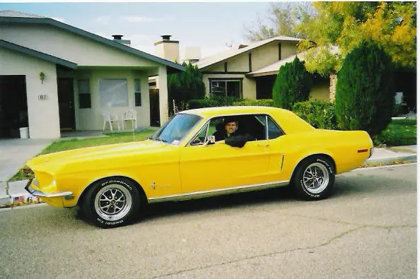

I also have 620 1" drop coils - I have 5 leaf mid-eye springs from Laurel Mountain Mustang. It sits pretty level as you can see in the picture.
<img src="http://forums.stangnet.com/attachment.php?attachmentid=32132&amp;stc=1" border="0" alt="" />
