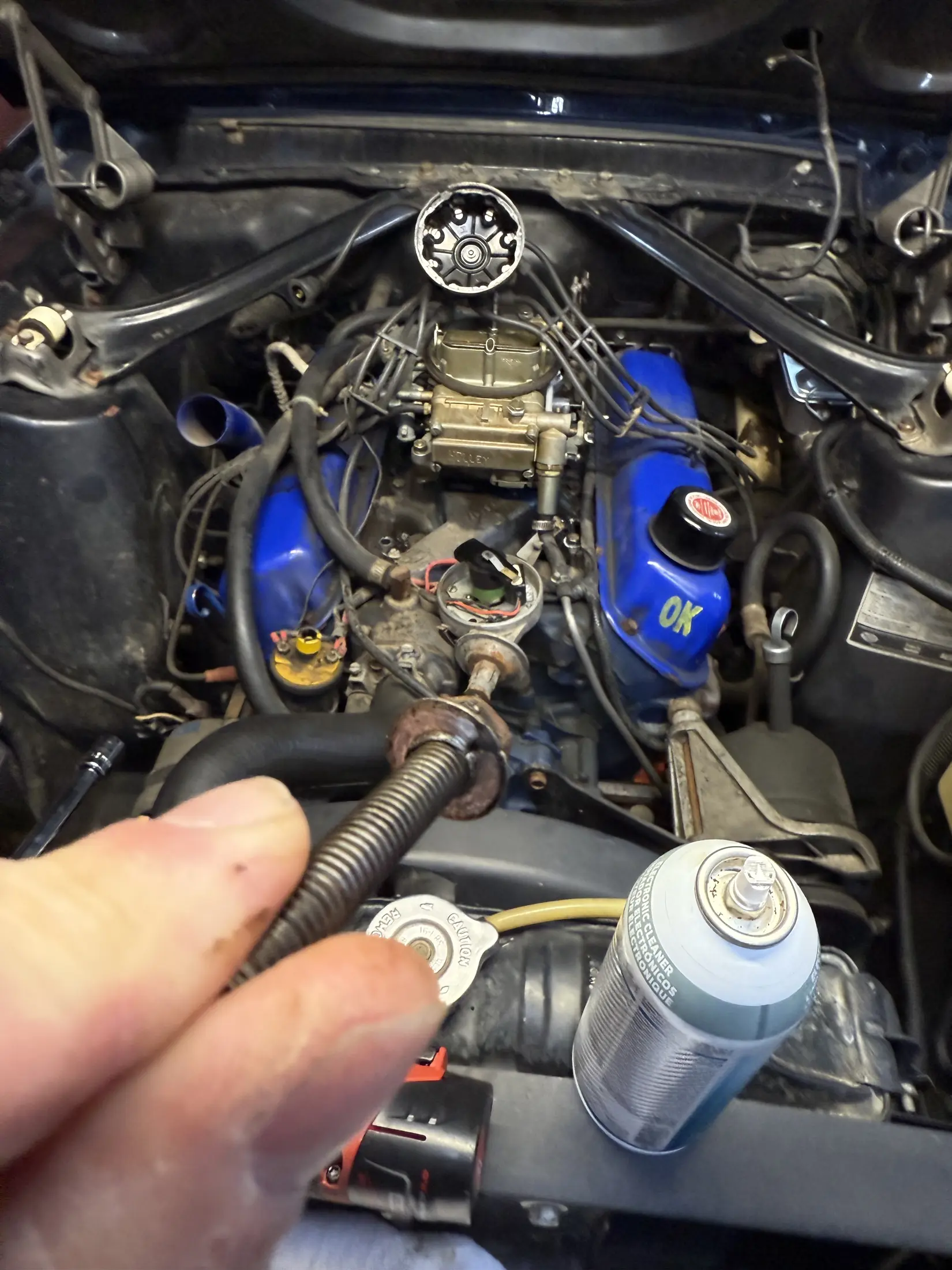

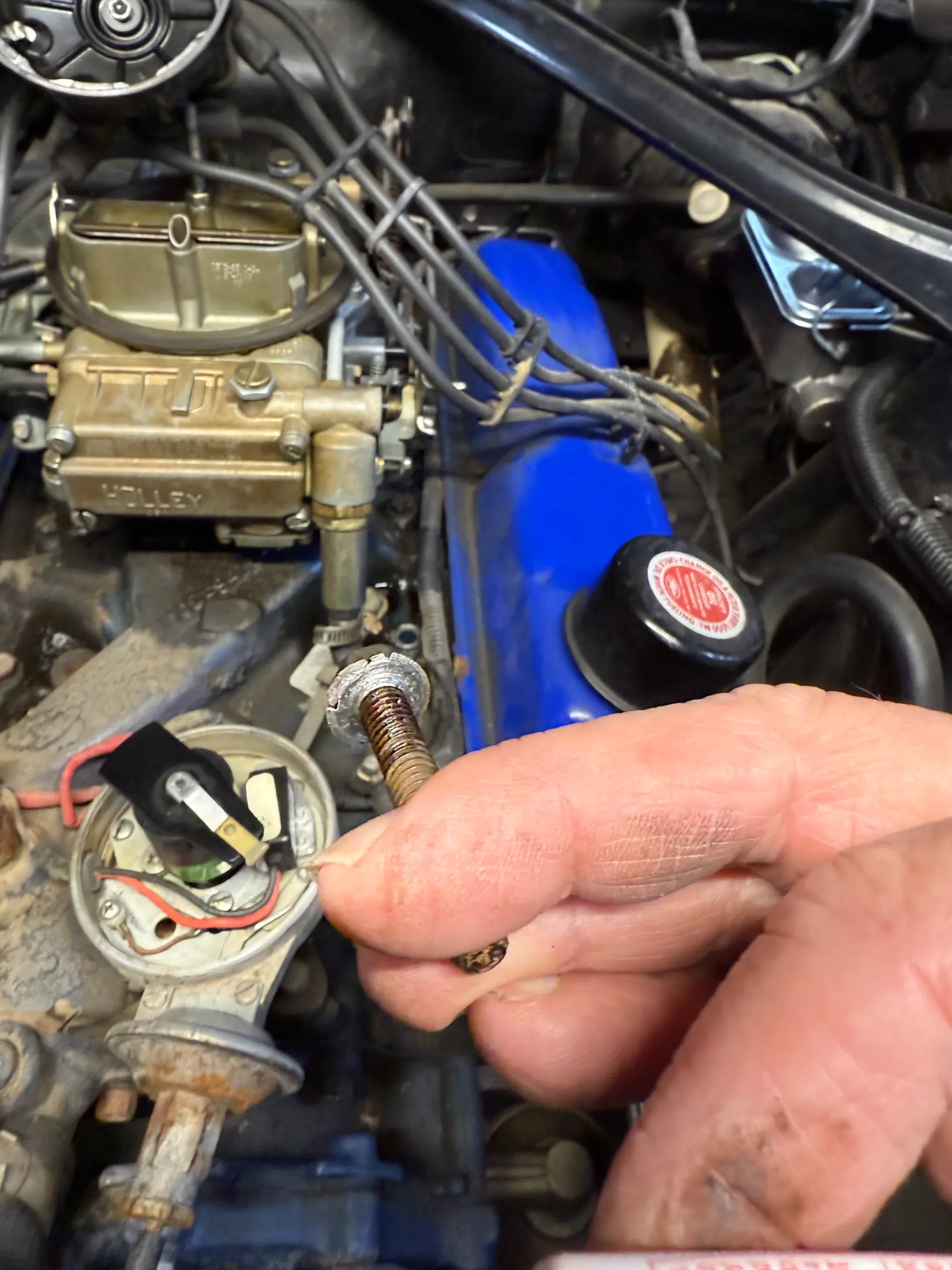

I have puddles of oil on top of my Intake in a new to me 1967 coupe. The car has been neglected but over all in great shape. Anyway I took the 4 bolts out that go into the oil gallery.
I’m assuming this is the cause. Just looking for some verification. Valve cover gaskets seem to be good.
I had exactly the same thing happen, fuel on the intake which I thought was oil at first. When I first got my current '67, it had a wrong year Autolite 2100 (a red herring in this context). This carburetor was leaking at the accelerator pump and the fuel pool looked like an oil pool.
I now have a correct year & size Autolite 2100 carburetor that I rebuilt last year. I am in the process of getting it dialed in, etc. This Summer I had a bit of flooding due to heat soak, which I am taking care of. It flooded and I could see a bit of fuel "seeping" from the throttle shaft, not enough to cause a leak and pool on the intake this time, but something I'm going to be on the lookout.
Sorry for the long winded way of me saying " yes, I had a fuel leak that pooled on the intake that I thought was an oil leak at first."
