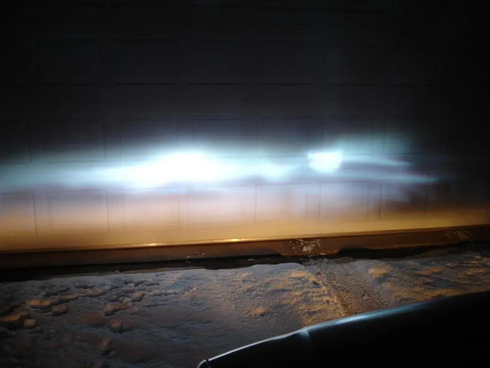

Idiots are giving HID's a bad name because they swap out their normal halogen bulbs for HID's, and keep the OEM lens that is not made for HID housing. This causes unacceptable levels of scatter and can blind other drivers.
HID retrofits using a projector housing keep all the light BELOW the other drivers vision. The only way to swap in HID's into a car that came with halogen standard, is to get a new lens/housing or retrofit projectors in
Proper HID cutoff
Improper HID cutoff using a halogen housing
Notice the hotspots in the center, right in other drivers field of view.
Notice the clean cool cutoff of a proper HID projection lighting system. Even light output, safe.
Johnny ricer puts HID's in his halogen housings and yeah, it looks a ton brighter, but the usable light is less than a proper retrofitting, and I dare say dangerous and less efficient than halogen
