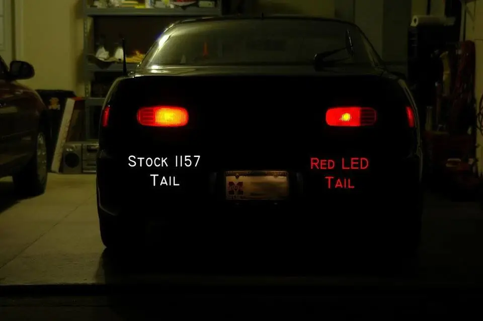

I saw some like those a couple years ago. I wouldn't waste my time on them. It seemed they did not "light" the housing and lens enough to be better than a regular bulb. I would use those from Mustang Projects but they are more $$$.
one problem first generation 1157 led bulbs had was that they did not use the factory reflector to amplify the light put out by the led's. the bulbs you referenced do. they are also the super bright led's so that will also make a difference. besides at $5 you cant go wrong.
This is why the LED replacement bulbs are not the way to go. That produce a hot spot in the middle and dim on the sides.
One other problem is that they do not draw enough amps to make the stock flasher work properly. It will still work but at a much slower rate. If you change the front markers to LED also then the flasher will need to be replaced with one designed for a LED system and very low amp draw
