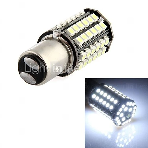

The Led bulb I was referring to isn't intended to replace a "halogen" bulb, I was talking about a standard 1157 turn signal/tail light bulb. And those bulbs are incandescent. The same old assed bulbs that went into a car right after they stopped using fire.
When you look at an led replacement for a standard 1157, there are in fact dozens of them on one bulb. All interspersed in a pattern completely around the bulb to act the same way the old one was intended,..., to be reflected.
I just can't see how this would be any less bright than the one Fred Flintstone uses, and other than the brightness, nobody's gonna be the wiser.
The design of that LED bulb is it's shortcoming, and the picture of it lit shows exactly what I am talking about. It's attempting to replicate the wide dispersal pattern of your standard incandescent by using LED's which have narrow focus points. You can see the hot spots and dimmer areas on the lit bulb. The individual LED does not have the same intensity as your standard bulb, so manufacturers try to increase the number of LED's and point them all over the place. Problem is it's just not efficient when used in a reflector.
I equate dropping LED bulbs into reflector housings to sticking HID bulbs into reflector housings. It works, but it's not the proper application of the technology.
Are LED's getting better? Yes they are. Household LED's have come a long way and my entire house is filled with them. I'm just not convinced automotive LED's are there yet to produce a satisfying drop-in bulb that matches the old incandescent. I've messed with quite a few over the years. In the end, they go in the trash and the old bulbs end up making it back in the car. They looked awesome, and were nice and clean and white, but when I decided I actually wanted to see what was backing into, I put the stock bulbs back in.

Mike- you have any pics of those bulbs in a fox tail light and what they look like when illuminated? I agree the aftermarket LED tail lights look horrble.
Not yet. it's my opinion that for the sake of the pic I furnished, the photo itself has been doctored to show all of the LEDs dimly illuminated........individually.
If it does in fact perform like it's supposed to I'd have to think all you'd see from a picture of a bulb illuminated will be just a bright assed light.
But,..I've got some coming for the front lenses, and I'll do that wiring today. And you gotta know that I'll be posting a pic of them as a testimonial to whether or not they suck.
