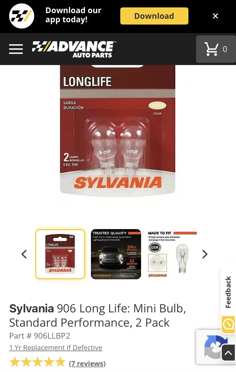

It’s a #906 bulb.
Advanced auto parts or any auto parts store has them. I used the sylvania brand #906 bulb 13v 9w.

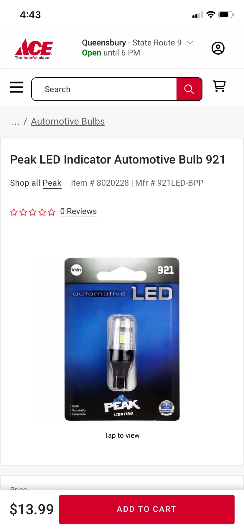

Here are a few bulb sizes that I can provide from my 91’ LX:
Under hood bulb #906 (LED #921, 916, 922)
