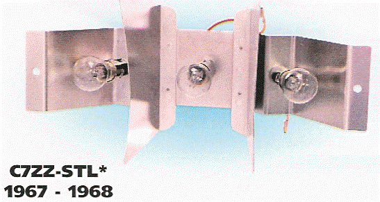

You mean like these:
You can buy them here or make your own.
http://www.mustangdepot.com/OnLineCatalog/Electrical/sequential.htm

Errr...guess those aren't LEDs but they are sequential. The photo hides the brains portion, no doubt to prevent home-fabbers.

It would work, but you would have to separate the housing into three compartments, and use three 1157 bulbs. I think that is what WORTH and Corpse (thanks 1320) did.
