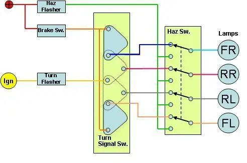

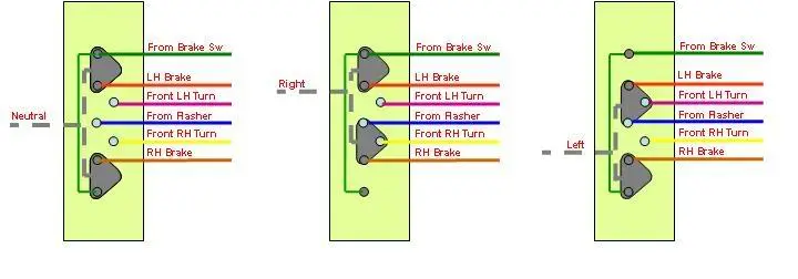

One wire bring the power into the turn signal switch from the brake switch.
When they turn signal switch is in the nuetral position, they are tied together, When you signal left, power through the flasher sends power to the left rear lamp and when braking, brake switch power will still be routed to the right lamp.
Visa versa for right turn position.
simplified diagram: (don't pay attention to the wire colors)
edit: I meant to put in this pic:
