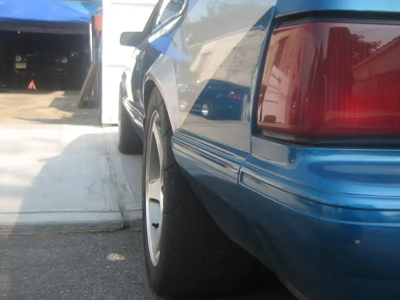

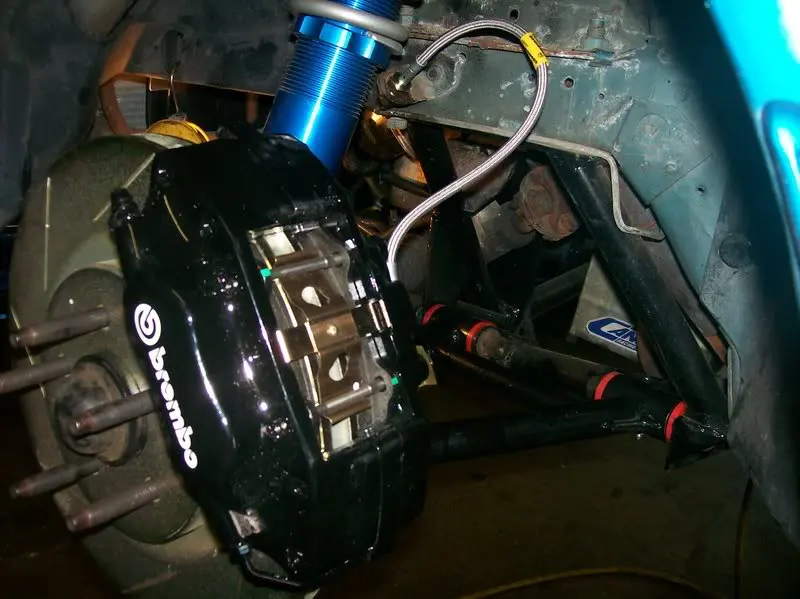

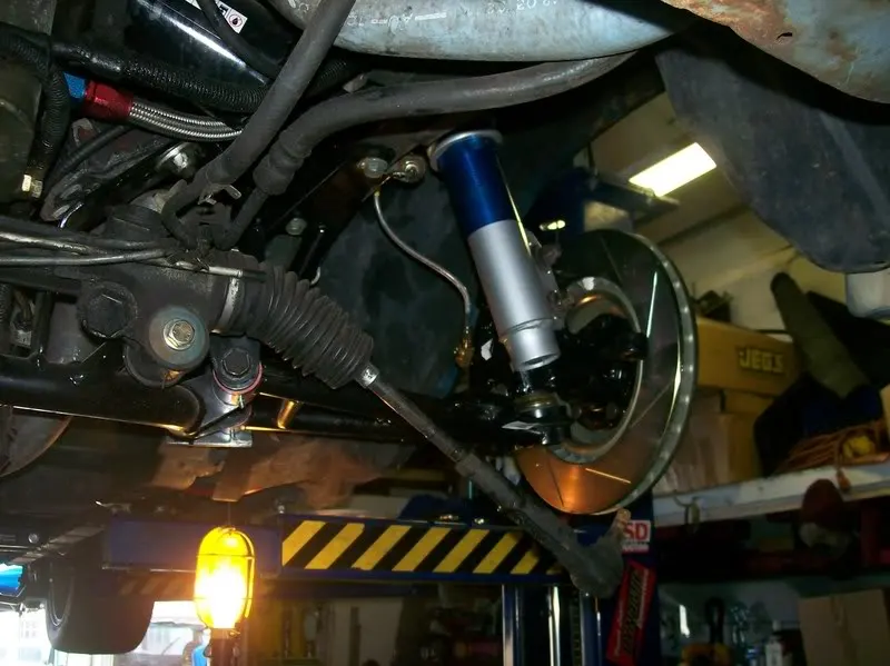

I keep going back and forth with the MM K-member. It's the only aftermarket k-member I would even consider puting on my 92 street driven car, but I keep hearing all these problems with wheel fitment and fender rubbing problems. And I think that the wheels moved forward and not being centered in the wheel well would drive me nuts.
So if anybody has installed pics of the MM k-member that would be awesome! (Tried to use the search function, but couldn't find any install pics)
