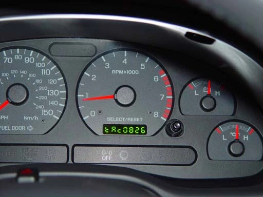

  • Apr 14, 2004
Digital

holy poop, jas how did you get that? that rules! PM ME! PLEASE!

to get the "digital tach" all you have to do is hold down the trip button, turn the car to power on, then release, then turn the car on i belive. then you just press it down to change settings.

tried it. First time it said "GAUGE" and all the gauges maxed out. it was pretty cool. i was going to take a pic because the speedo was maxed, so was the tach, hehe
second time, it said "TEST" and i dont know if anything happened... i dont think so?

Just keep pressing. Eventually it will read temp and voltages (althugh in weird comp lingo and not in volts or degrees) and it will read speed (in MPH) and RPM's.
