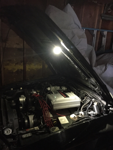

Bulb #67. Underhood light. I believe this changed around 1989 so might be different. Useless light anyway

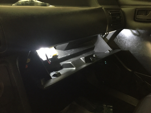

Glovebox. #194 bulb

Glovebox. #194 bulb

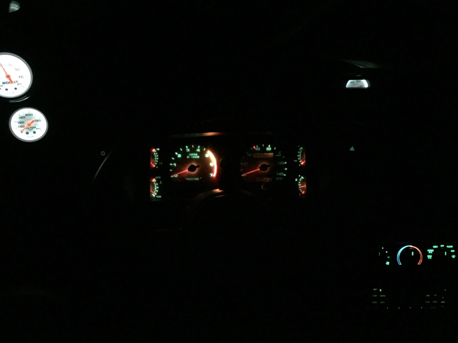

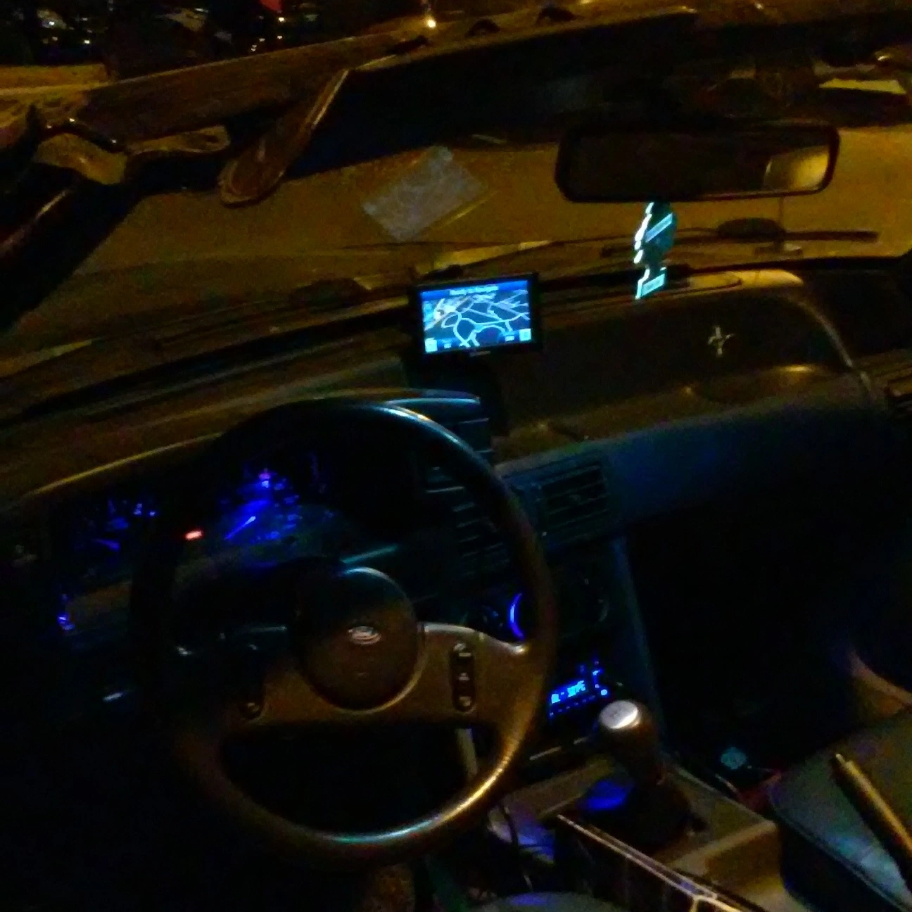

I've been working on this for a while now....but I want to change EVERY bulb in the car (save the headlights/foglights) to LEDs.
Thusfar I have changed the front and rear turn signals, reverse lights, dome light, corner markers, 3rd brake light, hatch light, & license plate lights.
Every bulb I've bought has been from SuperBright LEDs. They are fantastic. I have also found V-LEDs and they look intereting but I have not purchased anything from them yet so I don't know if they are brighter than SuperBright's.
I will take & post up some pictuers when it gets dark so that things can be seen better.
Eventually, I want to change all the bulbs....the dash illuniation (including the headlight/hazard switches), the glove box, everything.
The next project is to make the corner markers blink with the turn signals. Because of the reduced draw of the LED lights, there is no risk of running two full size 1157 type bulbs in the front. I've ordered a new set of diamond clear corners from 50Resto and when I get them, I'm going to dremel the opening to accept the full size 1157 socket (which I cut off of a junkyard ford) and then wire everything up together. Thus making both the inside and outside lights blink when the turn signal is activated.
After that, its the brake lights and rear markers, then moving on to the dash.

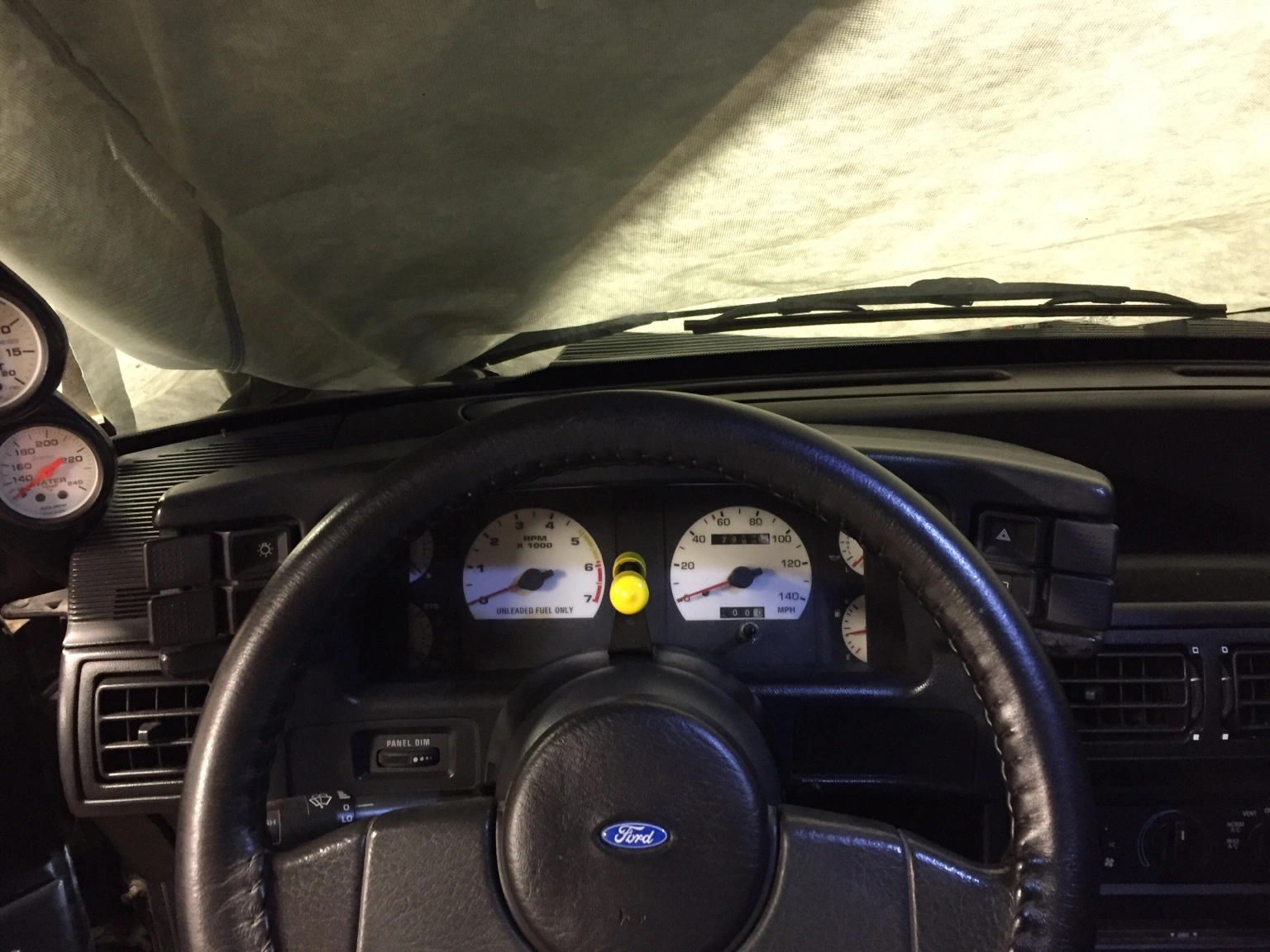

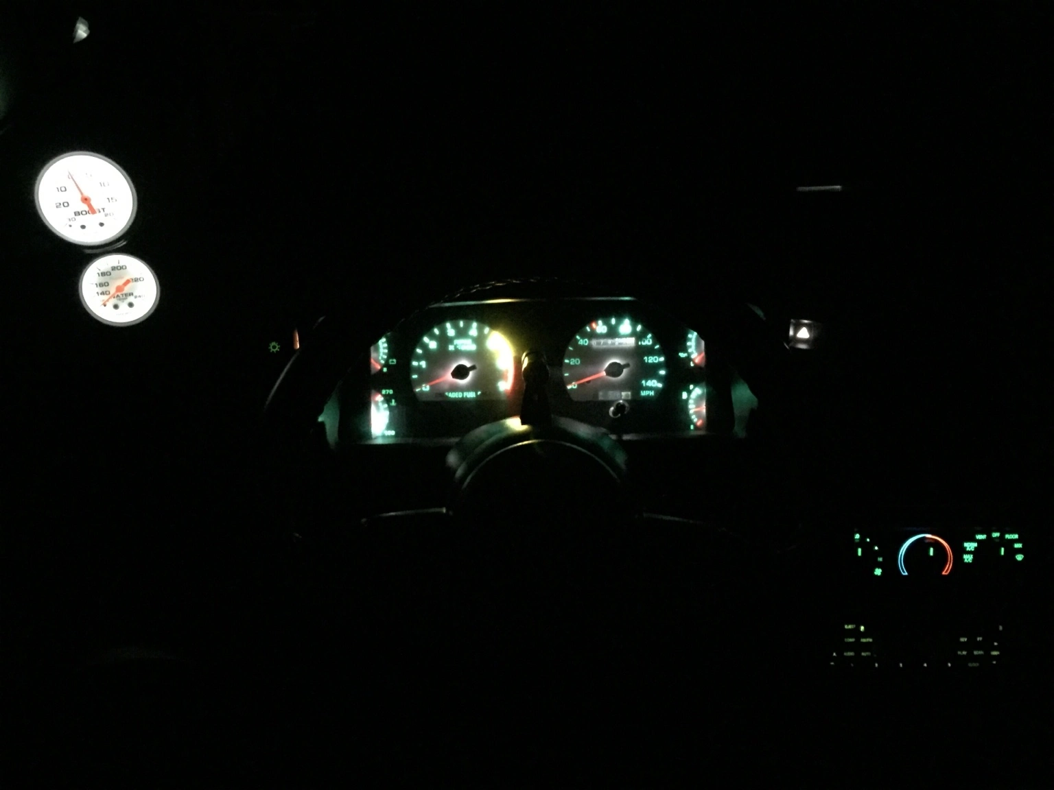

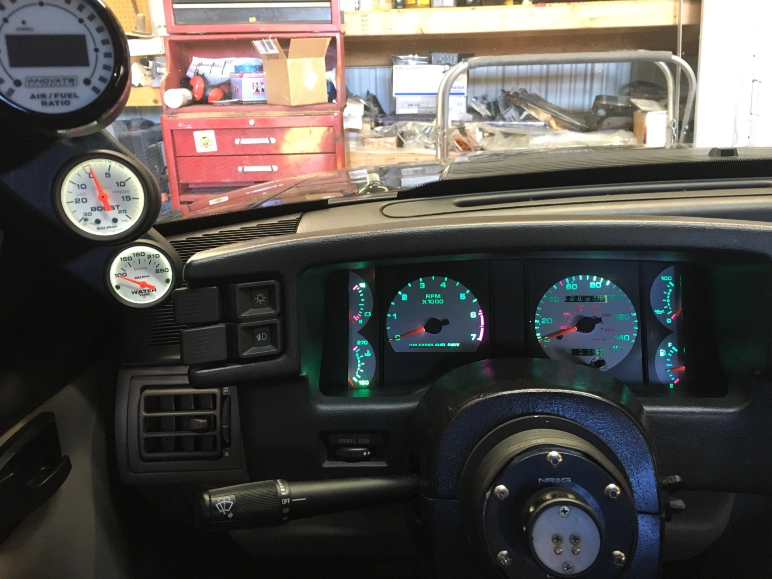

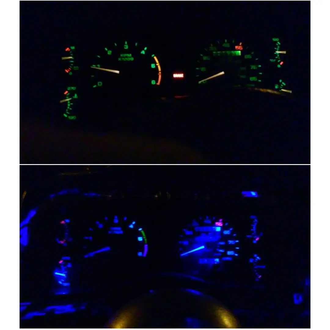

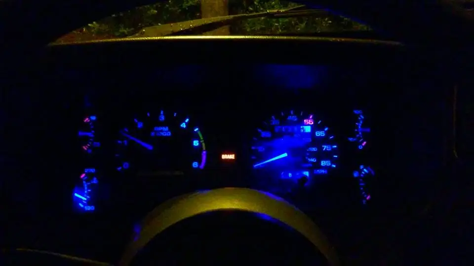

Ok. Got to the cluster. Not really happy how it came out. I don't plan on doing much night driving, but I still had to tackle this.
Years ago I got BBK white face gauges. They had horrible night illumination. Thought led would fix that.
Daytime pic
before
And after adding LED
They aren't as washed out as the pic shows, but still uneven.
Couple notes.
Had to use original bulbs for turn signal. Putting in LED causes blinker to be slower. No real difference in appearance anyway.
Seat belt LED briefly blinks when door switch is pressed/released
Dimmer only dims led on right side of cluster. Left stay bright
When replacing the headlight/hazard bulbs, get the led color you want it to be. I got white led thinking the lens was green. Nope, as you can see...hazard is white.
Not happy with this. Might have to change something

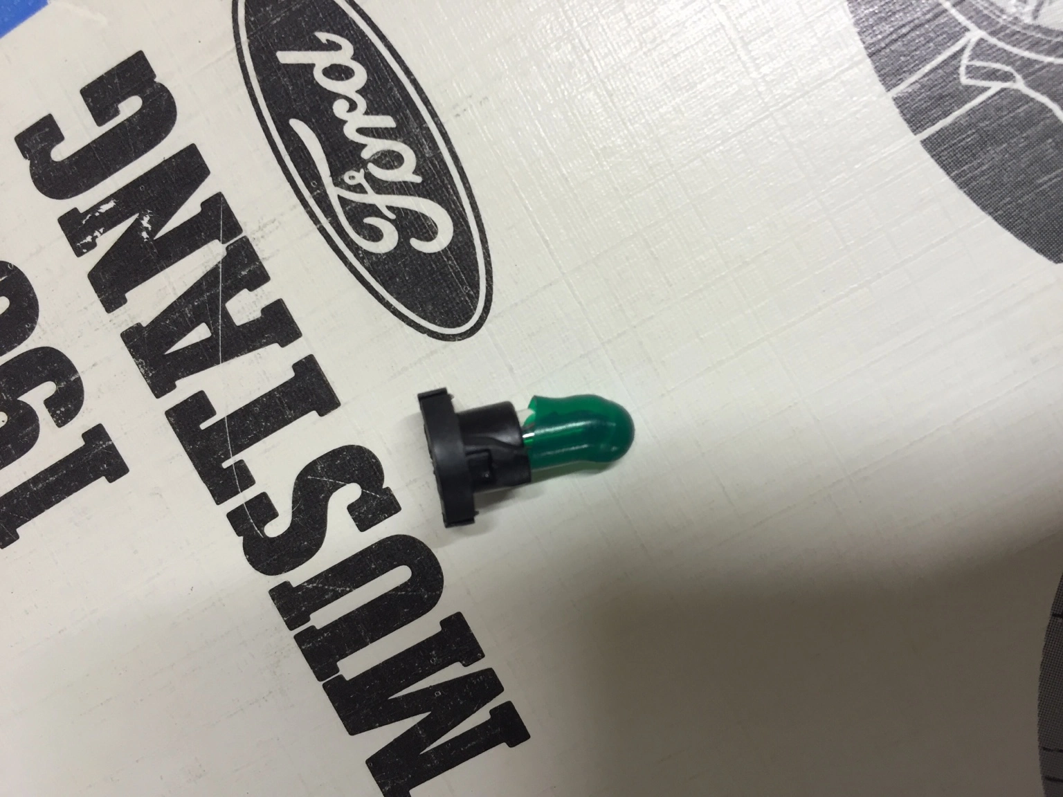

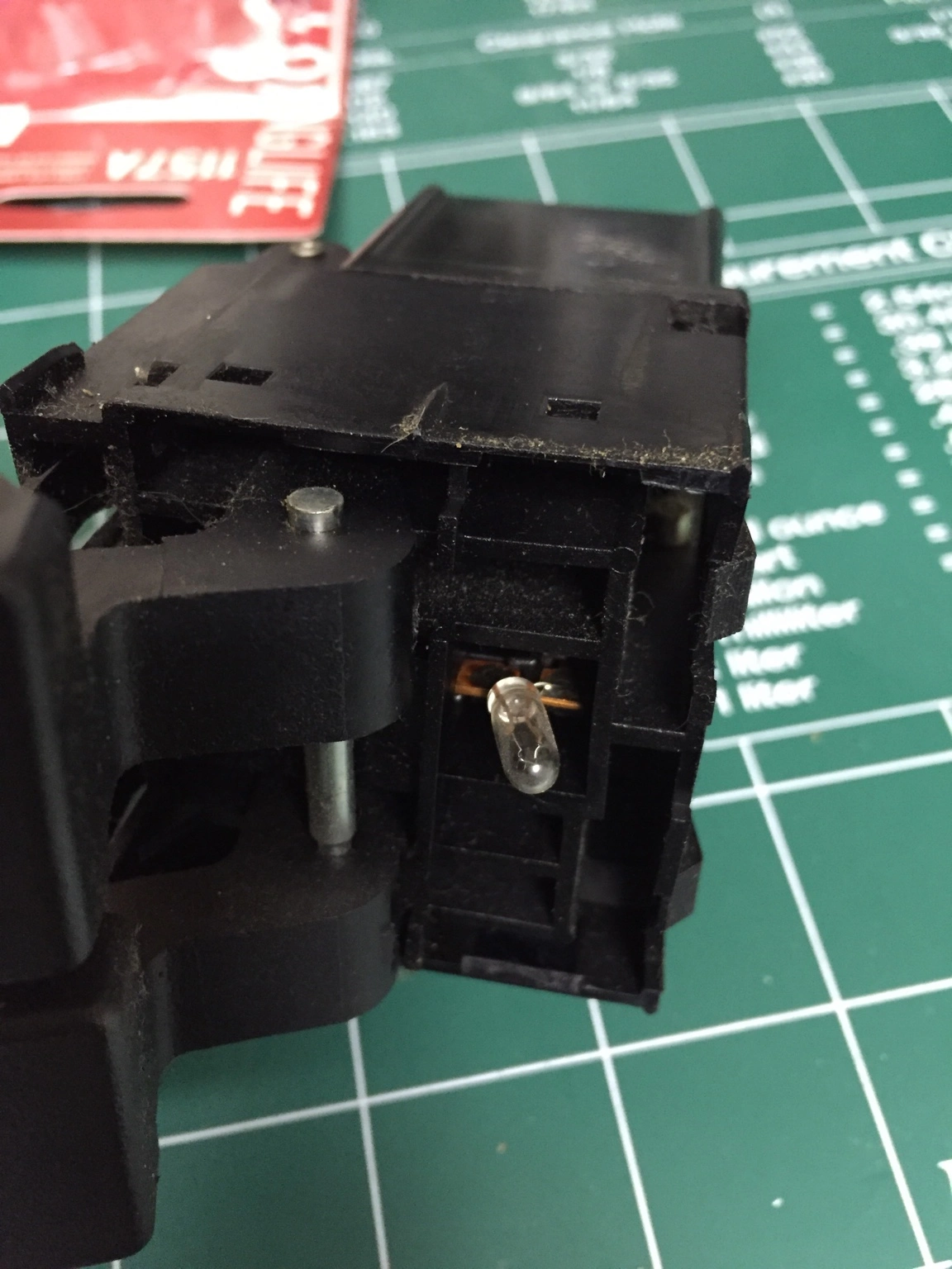

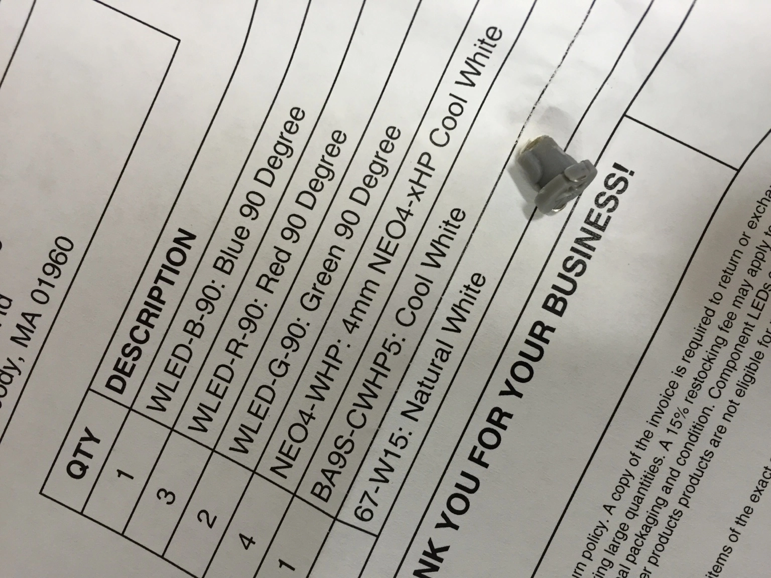

And in case you are wondering what's in the headlight switch.
Here's what the other side looks like. Technically it's the same bulb, just with the leads pulled into the socket to make the connection, and a green bulb sleeve
And here's what I attempted to replace it with. Part number 4mm neo from superbrightleds
Sent from my big ass iPhone 6 using Tapatalk
Daytime pic
before
Couple notes.
dont put an led bulb in place of the battery light or parking brake light or any of the warning lights. i only put one behind my parking brake and it stays on all the time now. ive heard it does the same in the other locations. in putting leds into the turn signal bulbs it does slow it down. if you were to go completely led all it takes is picking up a turn signal flasher that will work with leds.
Yeah, for the most part I left the warning lights alone. I did change out the high beam and check oil bulb and left the battery and turn signals alone.
For the most part I blame the guage faces. They never lit evenly, so I don't think they will even with LED.
I was gonna mess some more with it, but the reality is this is a car I rarely drive at night...or even drive at all. Maybe I'll keep an eye out for a stock 87-89 140moh cluster, but I'll let my OCD about this go and move into something else
That looks good. What type of gauge faces are those? They look a hell of a lot more evenly lit then mine
I got them from upr, probably about 6 years ago. The dim spot in the photo is even less obvious in person. I don't know if I got lucky with the overlays or if it's just a matter of cleaning the cluster after removing the factory faces. Not saying you didn't clean yours well, but I'm sure there are plenty who didn't.
Mine are BBK and I think I remember that the issues I had were quote common, especially with the 87-89 cluster because the bulb location for that dim spot in the speedo wasn't really ideal. The OEM faces had some sort of reflective backing that helped distribute the light evenly. These BBK ones didn't have them.
I may look into a new set of faces, but at the same time, I don't drive at night really so why bother?
Plus my pic makes it look bad. It's not as uneven in person. I'll just live with it
