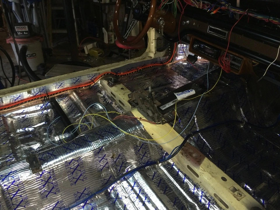

Ok.. so the interior is out of my fox while I paint it. I have all the factory sound insulation out. I've been looking at all the peal and stick stuff out there. Any of you guys use it? Just on the floor? What about the quarter panels?

Now is the time to do it. I was more concerned about heat than noise but it works for both cases. I bought the quilted foil backed stuff. It went down easy enough while everything is out, I just did the floors and I don't know if it made any difference or not since I never drove the car much without it. It will never hurt anything.

I used the dynomat heat shield stuff, there were not that many choices when I did my car, I covered the inside from the toe boards all the way to the tail light panel. It did help with the heat. I did the same thing in the dump truck, a definite difference. I didn't do the roof but I will very soon. I can't tell you if it really lowered the sound level,
Had the mass back foil stuff in my convertible from the firewall to the back of the rear seat. That stuff works great. Need to do my notch back. One day...
