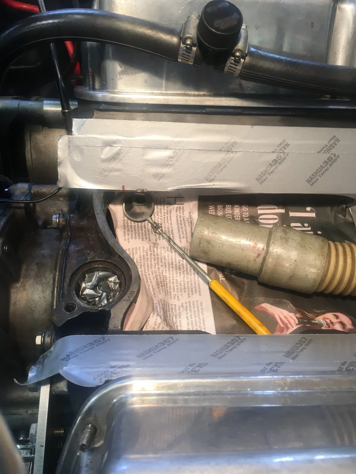

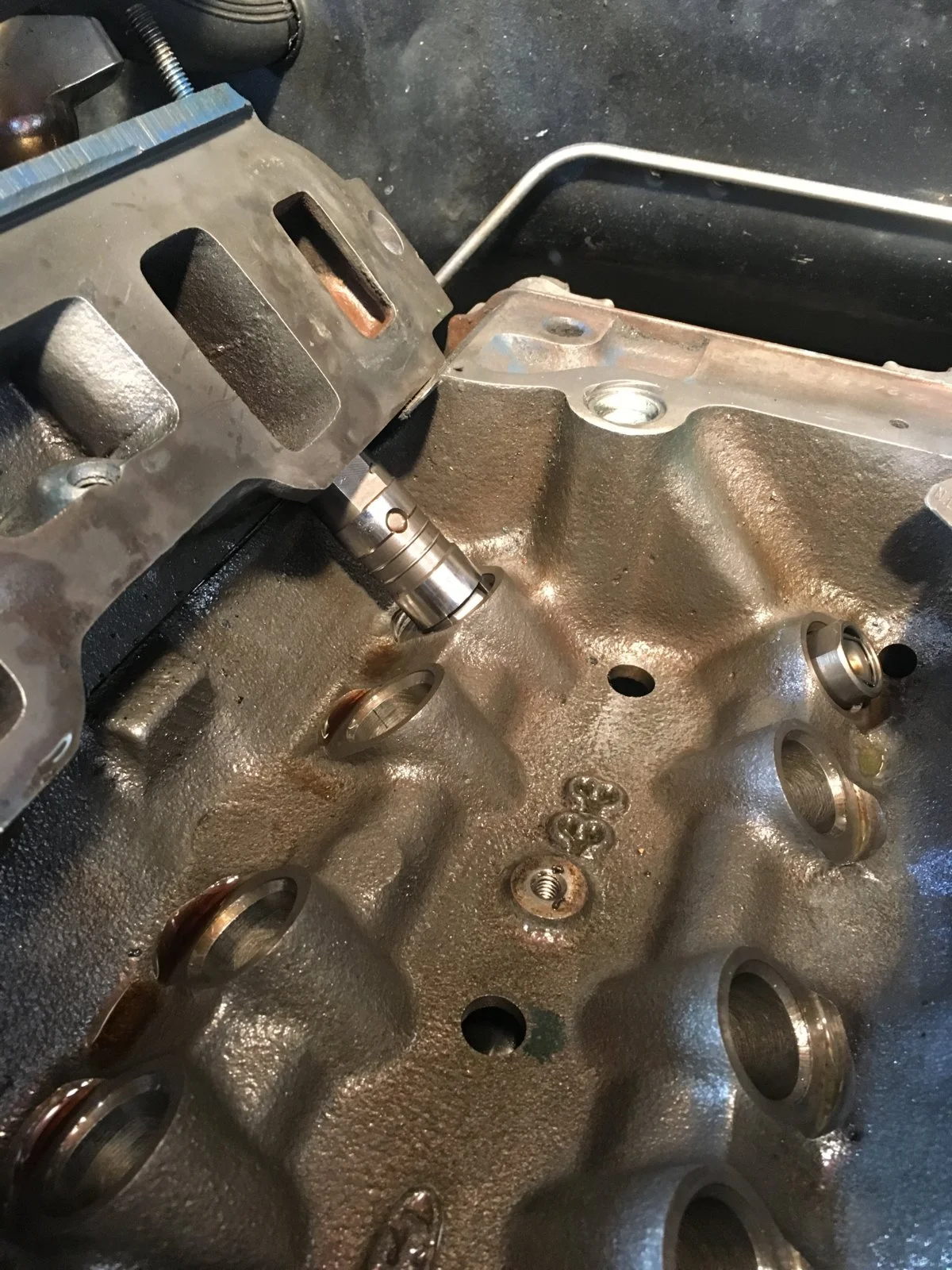

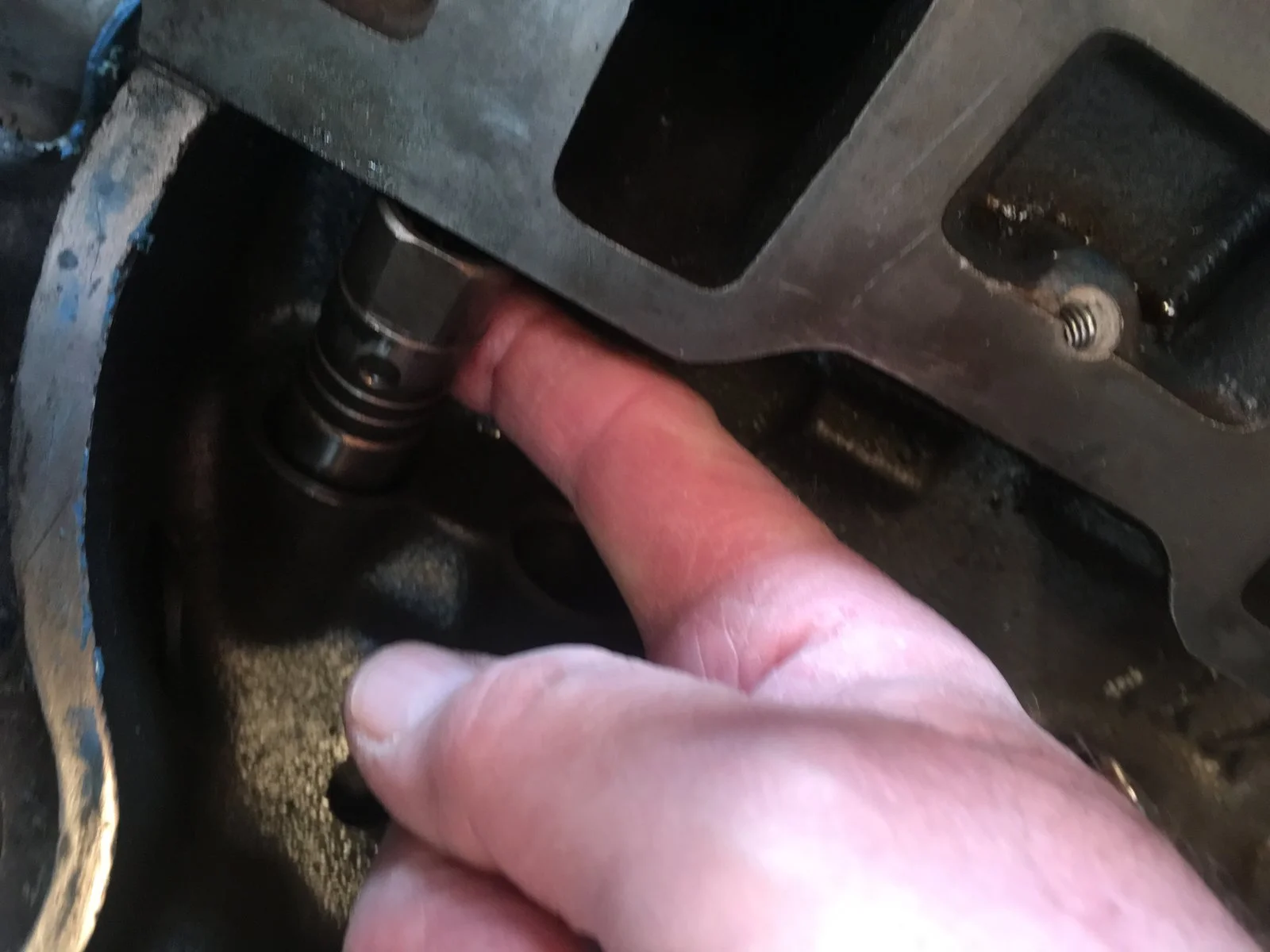

I’ve got a new set of roller lifters for my Comp Cam in my 302. Is this a cruel joke? See photos. There is not enough clearance to pull 1i, 4e, 5e and 8i lifters from
their bores. Before I take my die grinder and remove some material from the underside of the head flange, has anyone else experienced this? What I thought would be a simple remove and replace has now become a major PITA....

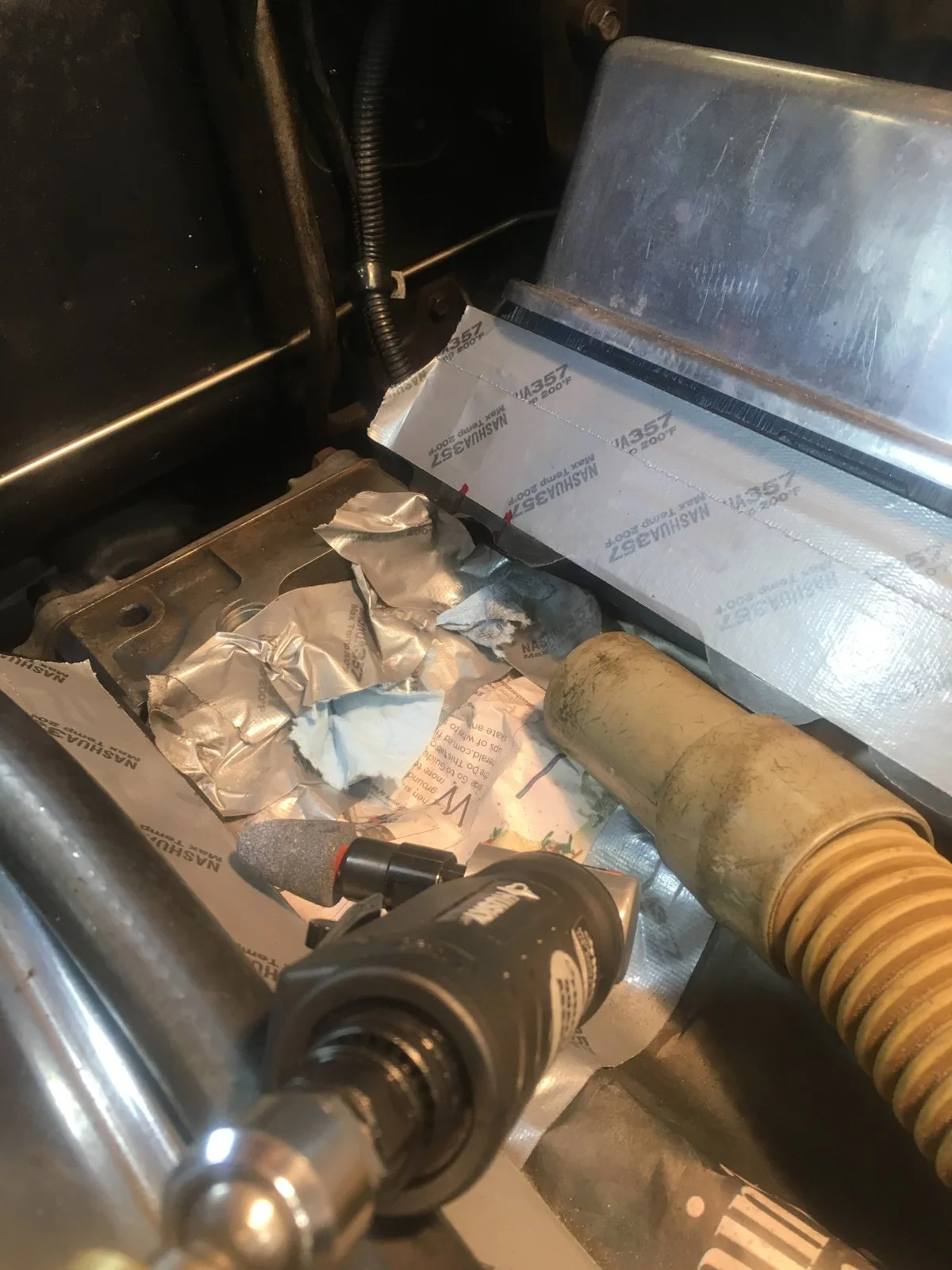

OK, well here’s my solution. Die-grinder and vacuum pulling away the grit / shavings. All lifters removed.

You pretty much have to do what you did, though most people take the heads off and clearance them off the car. I've never had a problem removing my lifters but I've heard of people with certain combos having issues removing the four corner lifters. IIRC, they were all aftermarket iron heads.

@RaggedGT No sweat; I was able to remove enough material to pull all the lifters; I need to remove just a bit more to slip the exact same new roller lifters into the bores....crazy. Yeah, pulling the heads was the only option that I wanted to avoid. Fingers crossed.

Those look like the Ford Racing R302 or R302H lifters. If you read the fine print, they are slightly longer than the factory replacements.
Hit or miss on what heads allow enough clearance to remove with heads on. My TFS170s allowed enough room to pull them. Other heads, as you have found, won’t.
Well, having taped-off the heads and valley while running my shop vacuum catching the particles off the die grinder, things are quite clean with respect to the fallout. While removing the heads to install the new lifters would be my first choice on an bare engine, the 16 header bolts and their safety wires was what put me onto this process. Each notch took 10-15 minutes with the die grinder.
