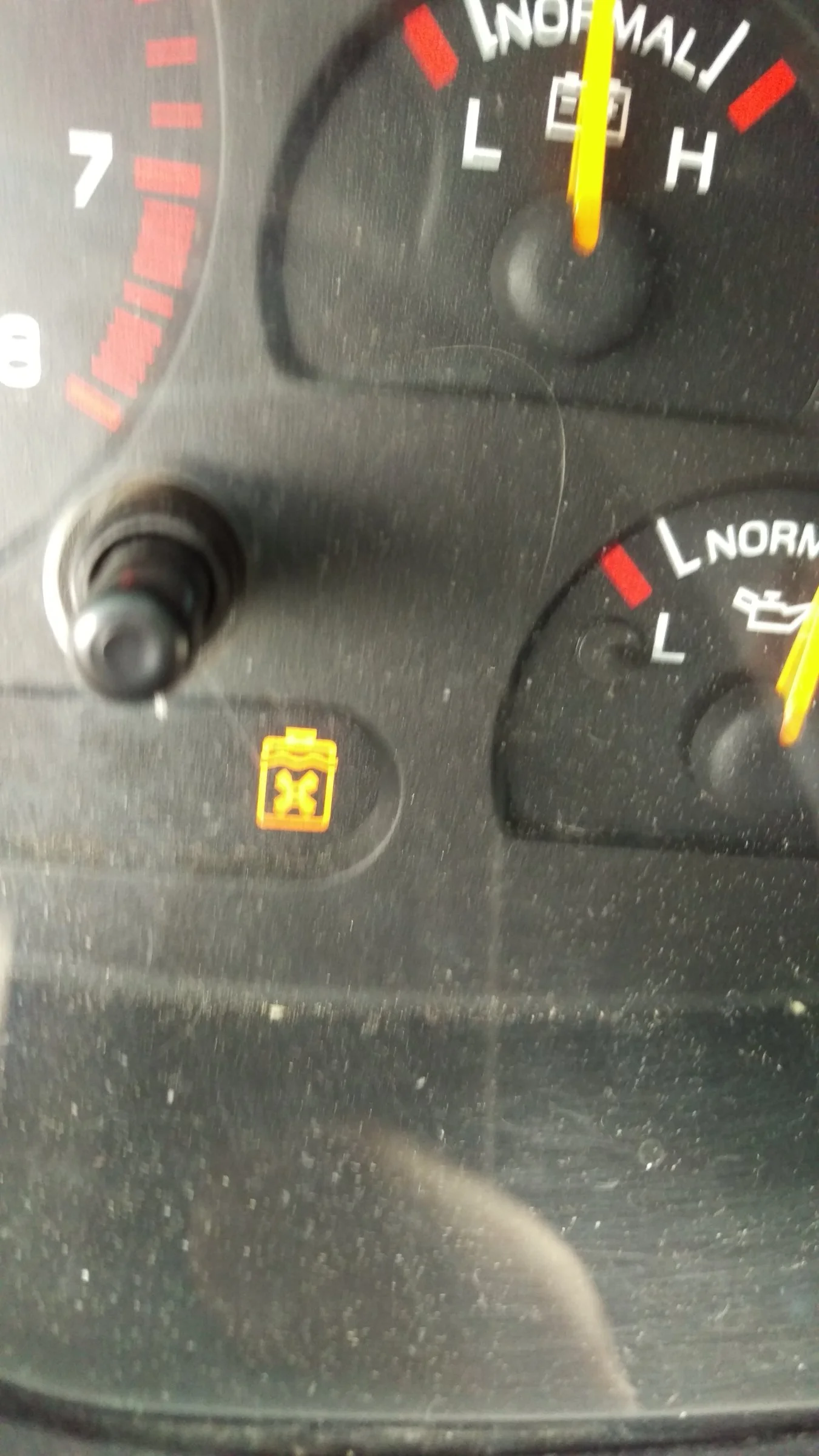

Matt Wesner Member Apr 28, 2017 7 2 13 Vancouver, WA May 31, 2017 #1 May 31, 2017 #1 I have this light on my dash. It comes on and goes off. No particular amount of time. Doesn't flash. Stays on for a bit then goes off. I thought it was a low coolant light. Coolant is full needs to be changed but full. Thanks guys. Attachments IMAG0269.webp 172.8 KB · Views: 191
wmburns SN Certified Technician Aug 14, 2009 5,892 514 204 Houston Texas May 31, 2017 #2 May 31, 2017 #2 It is a low coolant light. But I bet that if you checked the float in the de-gas bottle you will find it stuck to the bottom.
Matt Wesner Member Apr 28, 2017 7 2 13 Vancouver, WA May 31, 2017 #3 May 31, 2017 #3 wmburns said: It is a low coolant light. But I bet that if you checked the float in the de-gas bottle you will find it stuck to the bottom. Click to expand... Awesome! Thank you I will check it out. Had a feeling that was it but wanted to double check. Thanks again.
